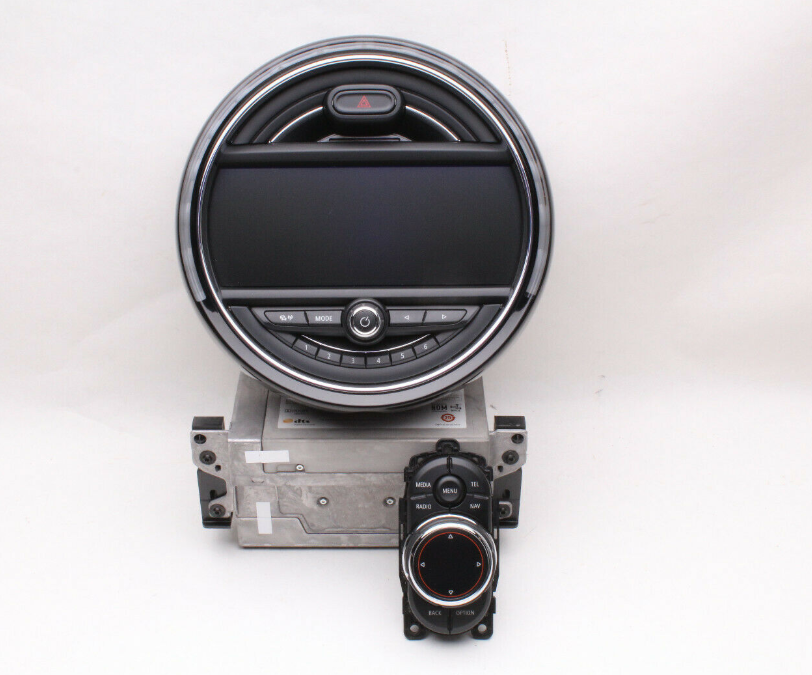

These parts are what I needed as I had the regular radio, if you already visual boost, which is the 6.5" display, the cost will be less and less work will be required.
Part #s and links:
Touchscreen: 65506820386
CID cable: https://www.ebay.com/itm/BMW-F10-F20...-/253205196176
NBT EVO Unit: 65128708270
Controller: 65829866934
Touch Unit: 65829371374
Emulator:https://www.ebay.com/itm/Plug-and-pl...19.m1438.l2649
USB Cable: https://www.ebay.com/itm/BMW-CIC-NBT...72.m2749.l2649
Wi-fi antenna: https://www.ecstuning.com/b-genuine-...n/61119308571/
Or
Bluetooth: https://www.ebay.com/itm/BMW-CIC-NBT...72.m2749.l2649
2nd microphone: https://www.ebay.com/itm/BMW-CIC-NBT...EAAOSw~0paRLt1
GPS antenna: https://www.amazon.com/gp/product/B0...?ie=UTF8&psc=1
FSC Codes: CarPlay and activation of navigation services ($250)
Create harness for audio control panel
My cost was about $2,000-$2,500

I upgraded my basic media head unit by purchasing a pre-configured for my VIN Head Unit from eBay. The only drawback by choosing this route will be that the HeadUnit will be delicate, meaning that you cannot casually update or code or flash this head unit becoz the system computer that was earlier tricked may wake up and brick your hardware. The advantage with this route is that it will work and will not cost a kidney or lung to execute the project.
I have a spare 6.5" assembly with the hazard button & radio controls & a beautiful wooden trim suitable only for MINI CountryMan F60 with 6.5" Touchscreen for sale.
#2-Part#61-319-354-506-->Control Assembly.
#3-Part#51-459-332-785-->Trim Ring 6.5"
#4-Part#65-509-354-026-->Housing for 6.5" display.
#5-Part#61-319-389-077-->Hazard Switch.
I can ship this part to USA with tracking number, if anyone is interested, can message me.Thank You.

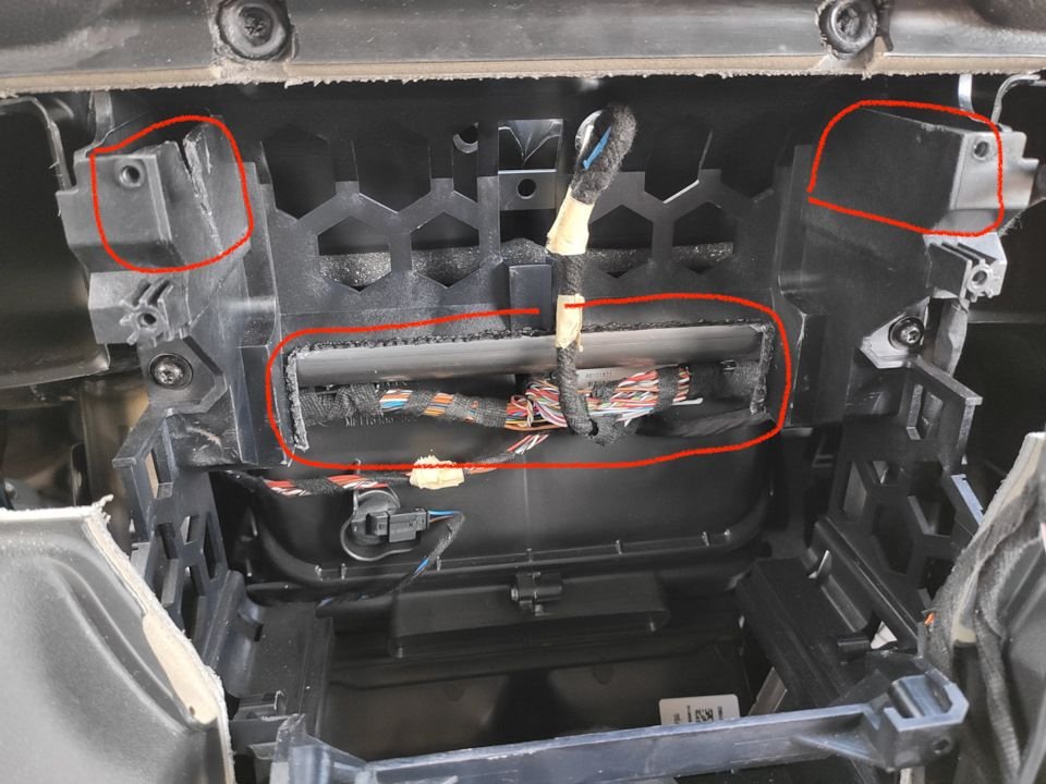

How did you manage to fit NBT Evo inside dash board? Dash board for radio basic is narrow than dash board for NBT Evo. Did you cut the metal arms of NBT Evo, or cut some plastics inside dash board in order to fit. Please explain what have you done to fit BNT Evo in. If you cut some plastics inside dash board, please indicate which ones and where.
Thank you in advance,
Marius

There is someone above who showed how they cut their dash, I had a temporary fix since I ended up replacing my whole dashboard, but I mounted sideways and worked well for the 1.5-2 years I had it like that.

Thank you for sharing!
The user above cut a dash already suitable for NBT Evo, I still wonder why. Perhaps he used a thicker unit.
