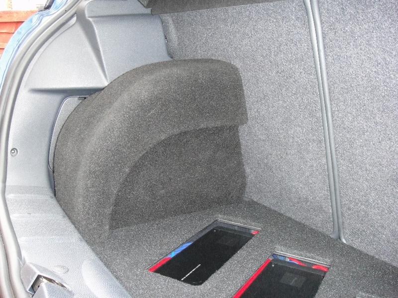

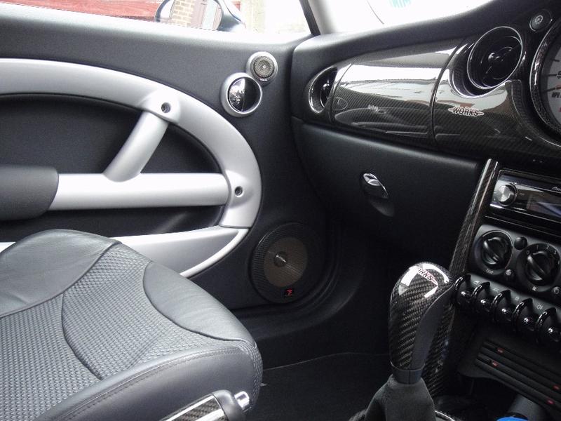

Here is my system, I'm a keen amateur, not a pro....as you can tell!

Originally Posted by spikeyadrian
Looking good, I too like where you have fitted the sub! Here is my system, I'm a keen amateur, not a pro....as you can tell!
That's a nice clean setup and you still have some truck space. Do you a picture looking in from the right side of the car?
Yes, no problem.
The sub is the JL Audio stealth sub specially designed for the 1st gen cooper.
The amps are the Pioneer PRS-D800.
Front speakers are Focal KR2's.
Attached Thumbnails Steps to getting where I need this system to be!-dsc00340.jpg   Steps to getting where I need this system to be!-dsc00342.jpg   Steps to getting where I need this system to be!-dsc00334.jpg
