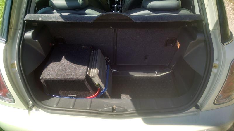

Already changed it up. Came across a sweet craigslist deal. 10" Diamond audio in a sealed box with a Pioneer amp mounted. Also came with an extra sub, another Line Output converter, and all the wiring for a grand total of $50. The guy had just upgraded to a new car and didn't want to mess with installing it.
