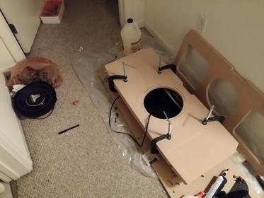

I was hoping to make a really thorough write up during my install, but it would have taken a lot of time I didn't have at the time. Instead I'll just post a few pictures and people can ask questions if they have any.

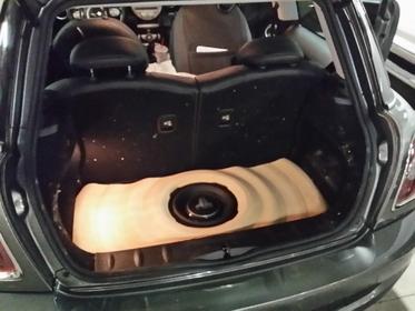

So here is the final product:

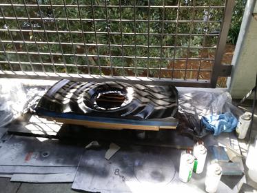

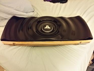

And here are some process shots:

I still need to take a nice picture of the finished piece in the trunk. Hopefully I will be able to in a couple of days.
