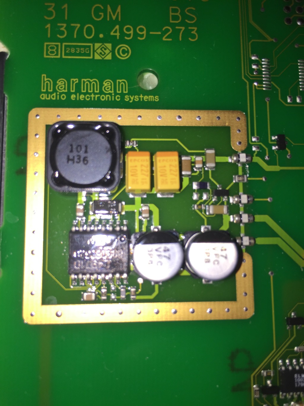

I am trying to fix my OEM Harmon Kardon amp..
Choo mentioned that one fix was using the digikey part number 497-4566-1-ND for the switcher. I was able to find this component on the board, but could not locate the 2 inductors....Could some one help me out and possibly tell me where these 2 inductors are located?
I have uploaded a picture of where I found the switcher...are the inductors nearby?
thanks!
thanks!
101 H36 is the coil. It's shielded.
I'm surprised you need to replace it, since they are usually fairly robust, as a coil of wire. If you can buzz it with a multimeter you'll likely find it's undamaged.
The two orange rectangles with 227 on are the 10V output tantalum caps.
The two round silver caps on the input are the higher voltage electrolytic ones. I'd inspect them for evidence of leaking.
Thanks for the response. Ill do my testing tomorrow. Are the two "inductors" (3.3v and 1.2v) visible on the picture I uploaded, or are those located elsewhere?Originally Posted by joylove
101 H36 is the coil. It's shielded. I'm surprised you need to replace it, since they are usually fairly robust, as a coil of wire. If you can buzz it with a multimeter you'll likely find it's undamaged.
There's only 1 inductor in that picture.
Once again, the inductor is unlikely to have failed.
Before attempting to modify any of the circuit, you should be able to measure the input voltage with a multimeter at the silver capacitors, and the output voltage at the yellow capacitors.
Thanks! Does anyone have a schematic for this amp? That would be an enormous help!Originally Posted by joylove
There's only 1 inductor in that picture.Once again, the inductor is unlikely to have failed.
