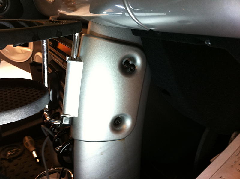

1. Remove the downtube screws (2005 model R50 shown)
2. Pull down on tubes and move out of way enough to get to 4 screws on head unit.
3. Remove screws and pullout HU.

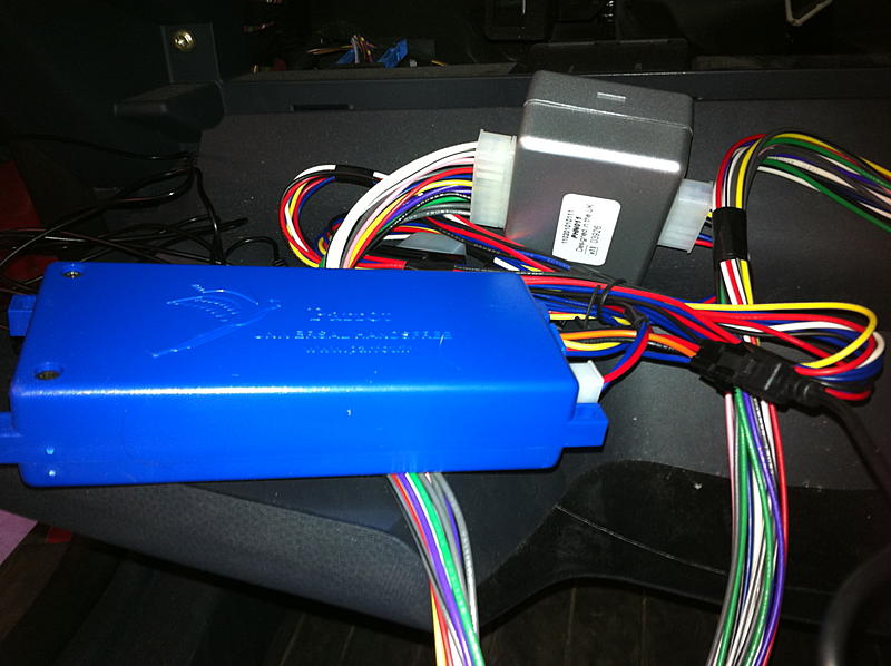

7. Plug other leads from newministuff harness to the parrot ck3000 device. Just match the plugs to the interfaces.
8. Relax, there will be 2 wire kits that come from parrot that you will not need.
9. Plug mic and parrot control button into blue unit.
10. You are done. If all is correct, your phone will pair up to your car when you turn the ignition key. If so, you will hear the car stereo click twice and the radio will display "phone".
