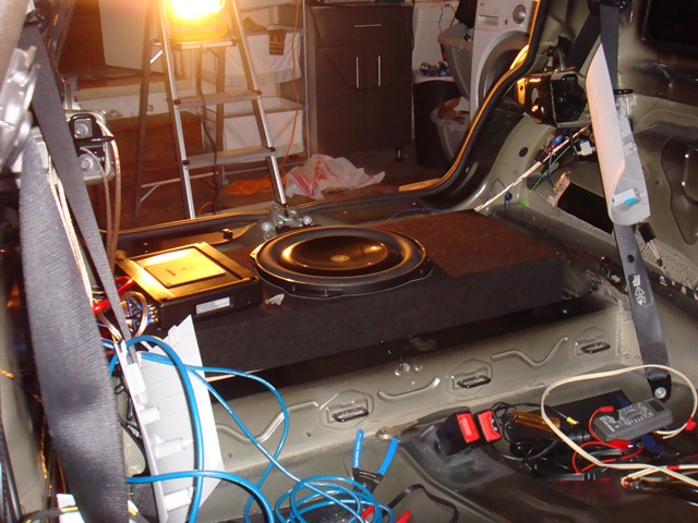

Went ahead and placed my order, of course nothing was going to arrive before the weekend so I started in phases. The sub was the first item to arrive so I started with the box. I took a page from tcowden's post here: https://www.northamericanmotoring.co...tallation.html and went a similar route for my box. I went with a slightly bigger box since I wasn’t going to need the space for the amps. All in all I ended up with 0.84 cubic feet for the sub.

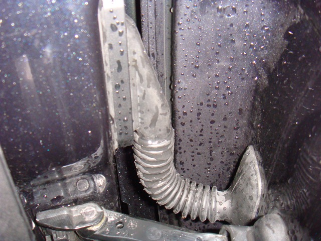

A couple days later the rest of the shipment came in and even though it was the middle of the week I chose ripping apart the MINI over spending time with my wife or getting work done. First came the door panels. I was dreading this part, but found it pretty easy. I wasn't going to go crazy and take the entire panel off, i was happy just replacing the speakers. After the panel came off and some investigation of my work area I recycled some masonite peg board (that’s right, peg board) I had laying around to create a tweeter housing to fit in the 3.5" speaker hole. The 6.5" woofer fit almost perfectly, nothing the dremel couldn't make quick work of. As for the speaker wire (sigh)...after examining the connector on the body for about 10 minutes I found that I could pull 18 awg speaker wire (two pairs) through the rubber tube and have them feed through the bottom of the hard plastic connector where there was a small amount of space. Front speakers in and wired into the cabin it was on to the rest of the car.
I removed the front passenger seat and as suggested in many posts I decided to pull the entire rear interior out. I found this post extremely helpful: https://www.northamericanmotoring.co...48-post41.html. For the inputs to the Alpine PXE-H660 I tapped into the front speaker outs from the x9331 connector and pulled speaker wire to the front passenger seat, going behind the front seats. Under the passenger seat is where i decided to place the h660 (after removing the Styrofoam). From the h660 five RCA cables run back along the right side of the interior to the amp.
Next was pulling power from the battery to the back right c-pillar, final resting place of the amp. For ground I used a grounding block i found by the passenger side 6x9, 4 awg wire was used for both pos and neg. Remote-on for the amp was provided by tapping into the aux power in the left c-pillar. Power and remote-on for the H660 was piggy-backed from the amp; the h660 power wire has a 3 amp fuse in-line.

...a few pics
Attached Thumbnails 2009 R56 Audio Upgrade-alpine-xovers.jpg   2009 R56 Audio Upgrade-back-sub-amp.jpg   2009 R56 Audio Upgrade-xr-5s.jpg

...and some more of the speaker wire in the doors
Attached Thumbnails 2009 R56 Audio Upgrade-door-1.jpg   2009 R56 Audio Upgrade-door-3.jpg   2009 R56 Audio Upgrade-door-4.jpg
