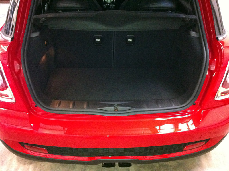

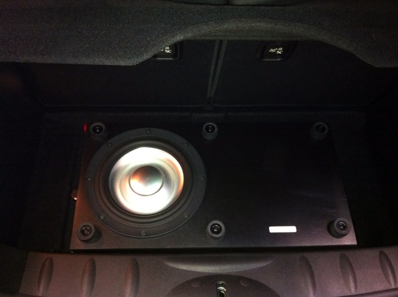

I apologize for the graininess of the pics. They were taken with my cell phone indoors and under fluorescent lights.
Devicemanager- it looks fantastic. Should be available from the factory that way! What kind of "hiccups" did you have that required so many emails to Kevin? Just a little concerned before I take the plunge.
A lot of our discussion was over the gain settings and Kevin taking the time to address some of my concerns regarding line drivers. The Arc amp accepts high level inputs (eg. speaker wires) and the line driver would take the high level and convert to low level and give you additional gain capabilities. Overall it's of no benefit and could introduce additional noise into the system.
I put a layer of Dynamat Extreme on the boot floor to help dampen the area. The styrofoam insert with the car jack and other tools still sits under the sub enclosure. I placed my Slime kit on the right side of the false floor to keep the bass from rattling the false floor against the rubber standoffs.
Per step 41 I opted to use a single rubber standoffs at all 6 locations so that the false floor sits flush. You put the washer on top and tighten the screw down until the washer is below the rubber edges. See image below.
If you enjoy the factory HK sound then adding the Integral Sub kit will fill the void from <100Hz.
