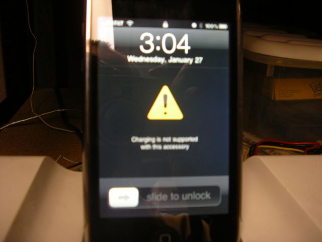

It's sort of a chicken and egg problem for me - if the interface worked, I would buy a dock extension cable in a heartbeat so my iPhone wasn't buried in the center console. And if I had an extension cable, I could determine what sort of voltages the adaptor is sending to the phone. But I'm not going to spend $40 on a cable that doesn't change anything. That said, when I decide I don't need to charge the phone, the fact that the MINI interface locks out the iPod app entirely is sort of a nail in the coffin for me. I suppose the mindset is that the iPod will be buried in the hidden compartment or armrest, or tethered to a barely long enough cable in the center console so you can't really use the iPod app the way it's meant to be used _anyway_.
I've attached some photos of what my iPhone 3gs complains about when I plug it in to my older iHome clock radio that only provides power on the Firewire pins. I'm _pretty_ sure that's exactly what it does in the car, too, right? I know that the mintyboost crowd has reported having charging problems with the iPhone 3gs, but I believe their current theory is that they aren't quite looking enough like a USB power plug to convince the iPhone to play along. My Griffin USB wall wart _occasionally_ throws up a "not a supported charging device" error, though, so I'll be the first to admit that the iPhone is a fragile charging platform. It hasn't been persistent enough for me to track down whether it's the adaptor or the cable or the color of my shirt or what, though.
There's a hefty discussion about the USB charging aspect on the pinouts.ru page for the Dock connector though, which rapidly goes beyond my enthusiastic amateur understanding of electronics. It seems to suggest that USB charging is more that stuffing +5vdc into pin 23, and instead involves driving the USB data lines high.
You could forego having it play music during that carge, or get a special Y-USB cable so you can plug in both the MINI Y and the USB car charger. There is a thread about doing this.
That's what my wife did in her Clubman, and it works well for her. Everything is buried down in the bottom of the center console, so it's not _really_ as hideous as it might seem.
Attached Thumbnails Iphone 3gs Y-cable compatible?-imgp0042.jpg   Iphone 3gs Y-cable compatible?-imgp0041.jpg

Originally Posted by pfriedel
Eh, mine is almost always topped off, and I haven't had any better luck than the usual iPhone owners. It seems as though MINI is doing the usual booboo, which is sticking to the 12v firewire charging spec instead of the 5v USB charging spec that Apple told manufacturers to prepare for well before the 3gs generation of devices hit the scene (i.e. Touch 2nd Gen, Nano 4th gen, whatever the creaky old HD based Classic gen is on, etc). The odd thing is that's exactly what the Scosche devices are built to convert, so the fact that they still don't work is sort of troubling.
it has NOTHING to do with the voltage. The MINI charges the phone with the 5v USB.
It has to do with the current draw of the iWhatever plugged in. I do not know how many times i have said this in these forums. 08 and 09 MINI's are confirmed to only put out a max of about 450ma and the new devices from Apple require up to 1500ma of current to charge. If that can not be supplied by the charging unit then the item WILL NOT charge. Also a note on this is that the iWhatevers are designed to go into Low Power Mode so as to be able to charge on the USB Low Power Specification under certian circumstances, and unfortunately the MINI does not provide the data stream required for the iWhatenver to be put into low power mode. The low power mode can also be initiated on some of the older iWhatevers via a resistor network in the cable itself but this does not work in some cases on the latest generations or iWhatevers.
Please note i have not had time or a 2010 car available to me to check on the current output capabilities of the latest ULF (drives USB port) module form MINI. Until such time as i can get to testing this I can only speculate that MINI has not changed the current capability of the ULF module.
But from what I am hearing here about the ability of some to charge their phones MINI may have made some changes. As to why someone can not charge a phone from that USB port while the car is not running may be a safety feature that MIN built in. I.E. this way the iPhone does not daring the battery on the car. This is the exact reason that MINI turns off the cigarette lighter sockets, so that anything plugged in does not cause a current draw and drain the battery while the car is not running.
Wrong see my information above.
