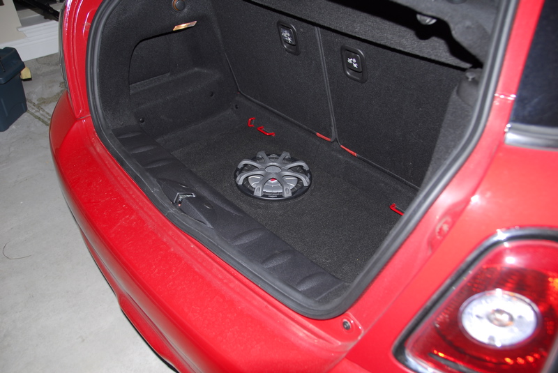

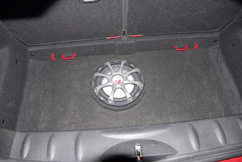

I had a bug up my butt and had to do this project. As everyone here probably knows the MINI has the worst stock system ever. So on my search went for a non intrusive way of adding a little bit more bass to the sound. I found nothing like I had hoped for. JL Audio used to have an ok stealth box but not for a 2009 and their new box was insane ($1,000!!!).
Anyhow I decided to build my own utilizing the tool space behind the seat. I built everything to include the box that encloses the speaker. This project was a blast and cost me under 50$ in materials and 300$ for the amp and subwoofer/wire. Here is the finished project.
Attached Thumbnails My custom MINI subwoofer project-_dsc1159.jpg   My custom MINI subwoofer project-_dsc1154.jpg   My custom MINI subwoofer project-_dsc1152.jpg

Looks good but doesn't it kill that storage space?

Great job KDF. I noticed that unlike other installs, you actually have some depth from the boot opening to your false floor. Most other installs I have seen on NAM would have false floors that are flush with the boot opening, if that all makes sense. That could also be attributed to the other installs having a larger driver, like 10" or 12".
It is great that you are able to save a ton of space, and still get your thump on! Looks great. Can't wait for the speaker replacements!

Thanks for the kudos. Yeah that storage space was negligible and only carried the jack and a pull ring. I have run flat tires and dont have a spare so honestly when am I going to use the jack and I just put the pull ring in my glove compartment so it worked out perfectly.
The aim for this project was to enhance the sound of the car's bleak stereo and not put a ton of bass in the car. This installation takes up very little space as compared to most of the other subwoofers that I have seen. Yeah its only an 8" woofer but it definitely provides the bass punch that I was looking for the price is unbeatable.

The 8" is fine I think u might be able to fit a 10" in there but I don't think the space underneath the speaker is suitable because the box that I built underneath the speaker wouldn't be big enough and the woofer would be starved for air. Another reason I think an 8" is an appropriate size is that it doesn't produce the standard license plate rattle.

Yeah theres really no great place to put the amp I tried it under the passenger seat but it hitting the bar on the seat every time someone wanted to move the seat.....I wouldn up mounting it to the back of the seat in the back. It seems to take up the least amount of space there.
