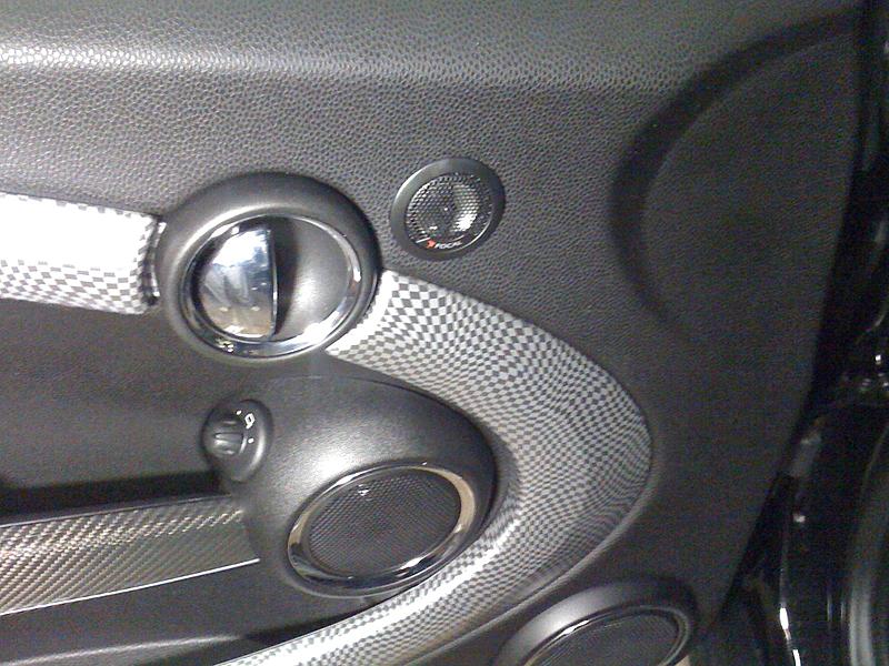

Pictures of tweeters
Jere are some pics fot eh tweet location and the alacantara upgrade done on the knee bar

Tweeters look good. How is the dispersion?
