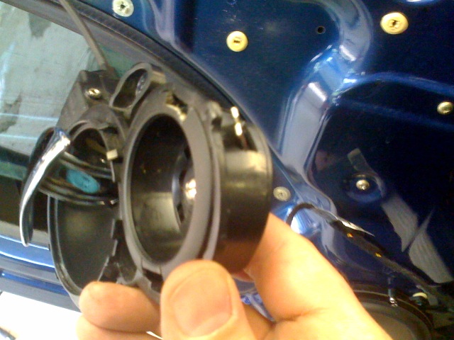

Install complete!
Ok I took some time today to get the front speakers installed. There's a bit to learn about these. Here are some highlights:
1. The mounting rings that come from Crutchfield are worthless. You can use the stock mounting rings that come with the speakers.
2. The tweeters can be mounted using the stock mounting hardware that came with them, as you will see in the pics below.
3. Crossover install is optional. I installed these without the crossovers and they sound great!
When you get the door off and the woofer out, mount the ring that came in the box. The holes will line up perfectly. Then use the wiring harness that came with the mounting hardware from Crutchfield and plug those suckers in. Next, unscrew the tweeter mount/door handle mount. Use the metal X mount that came with the speakers and wedge one of the wings under the tweeter mount (see pic). Then screw in the cup mount with the lip to the X mount. Then take the stock tweeter cover/door handle cover (the silver thing you see on the outside of the door) and line up where the tabs for the tweeter would pop in. They won't fit yet because the lip from the new tweeter mount is in its way. Mark off where the tabs would go in with a pencil. Then cut out of the lip a part for the tabs after you unscrew it from the X mount. Then screw it back on and run the wires for the tweeter through the back. Push the tweeter in place and wham! A flush mount tweeter install without using any additional hardware. Connect the tweeter wire (the red stripe wire is positive on both ends), button up the door and whammo! You got a new set of speakers!
Here are some pics to help out. Please let me know if you have any questions. The whole install took about 3 hours due to a learning curve. Hope this helps!
Attached Thumbnails Replacing front speakers... help!-install1.jpg   Replacing front speakers... help!-install4.jpg   Replacing front speakers... help!-install5.jpg
