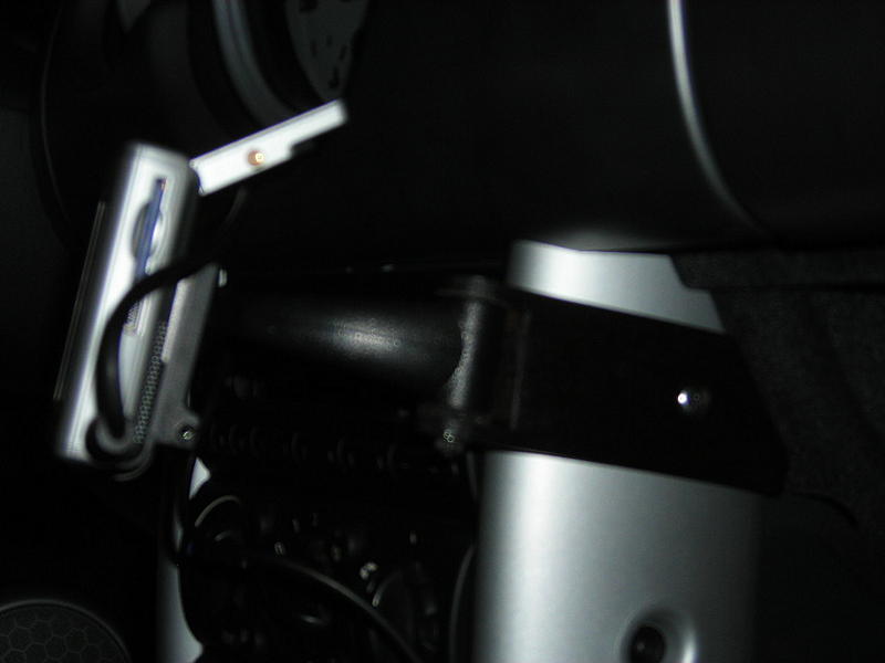

This is what i did

Originally Posted by MC 2
This is what i did
Could not see it clearly, but it looks like an and AUX plug that will go into the AUX jack and that is what I wanted. I had to order my 760, so I could not look at it first. Nobody in my area carries to high end nav systems. I guess they don't sell very well.
Thanks for responding,
Jim
Jim
Yes that is my AUX from the nuvi into the AUX of the mini and the braket
was costom make by me ,,what is fun about the braket it just at the right height so wen you play whit the nuvi the palm of you hand sit on top of the shifter so it give you a good control off the botton...
MC 2
MC 2
Now that is a good idea. I never thought about thatposition serving two functions.
Jim
