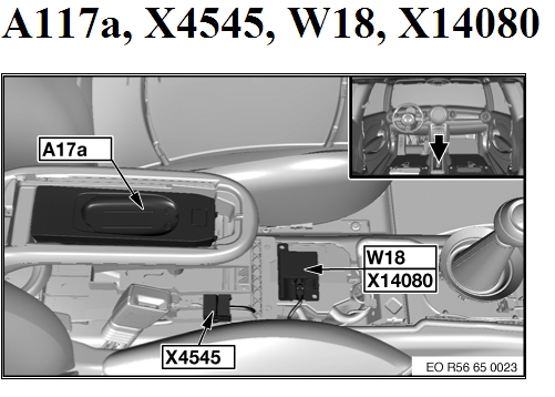

Does anyone know where the Bluetooth receiver antenna is in the R56
When using the Bluetooth, conversations can seem garbled as if there is some interference. Perhaps holding the phone closer to the receiver would alleviate this problem, but for the life of me, I don't know where to hold the phone.

I'd bet all your money your Bluetooth "problems" have nothing to do with the Bluetooth reception. I park under my house (house is on stilts), I can go up to the first floor, and walk around most of the 1st floor with the car ignition on, and the phone on my belt and if the phone rings, it rings in the MINI because the BT is still connected....
Most gargled BT quality have to do with the BT software on one of the sides (phone or in this case car). Since we know the cars BT is ok, it is probably yur phone. Make sure you have the latest software on your phone (if it's upgradable, like a smartphone or PPC).
But just for kicks, here is where the BT antenna is on the R56 (just behind the stick on the center console) where the "W18" is.

Thanks enjoyingthesilence and Birdman! It quite possibly could be my iPhone that is causing the problem. I have noticed that when I place my phone in the concave area just below the handbrake handle, the quality is improved--which now makes sense given the location of the BT antenna.
I had the latest 1.1.2 version, but I'll have to see if 1.1.3 is any better.
