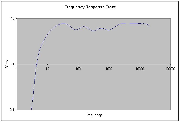

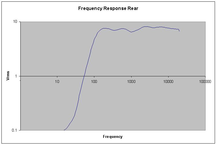

Check out the frequency response of the stock stereo. Measurements were taken from the speaker connections. I used 0db test tones and an oscilloscope with true RMS. Volume levels were set just below any signal clipping.
Attached Thumbnails OEM Stereo Frequency Response-front.jpg   OEM Stereo Frequency Response-rear.jpg

Wow, from those graphs it's clear that the low frequencies are cut from the rear speaker signal (hence why I don't understand that some people use this signal for their bass link or other sub).
I'm surprised to see low freqs on the front speaker signal however. If anything, I would have imagined the opposite.

raz636, I'm confused now. In your other thread, you wrote:
Originally Posted by raz636
After doing a few tests, I feel confident in saying that there are no crossovers in the non-hifi stereo. All the 6 speakers in the setup receive a full range signal. The front speakers are wired in parallel so they present a 2-ohm load to the stereo. Check out my other post titled OEM Stereo Frequency Response to see the audio signal the stereo is putting out.
but the rear chart seems to show a high pass filter:

Good post, but for anyone watching the thread that's not familiar with response curves, keep in mind that what you're seeing here is the *input* to the speakers, not a response curve of their *output*. Changing speakers wouldn't significantly change these graphs.
What these graphs don't show is how the factory speakers respond to different input frequencies, or how the airspace inside the car amplifies or attenuates certain frequencies.
Raz - were you using white noise, pink noise, or a series of stepped tones to make these graphs?

You're right. It is filtered, not crossedover. I don't consider the rears to have a crossover because it is a single output single input setup. Crossovers are used to send different sets of frequencies to more than one device using a single output. Take a look at the pic in this post:
https://www.northamericanmotoring.co...73&postcount=4
I used 0db single frequency sine waves. I made a test CD and just sat through it an logged the results.
The speakers frequency response must be considered if you want to analyze the whole system. Since most will change their speakers, I didnt see the need to test the actual sound produced.

Here's the graphs again but with a log voltage scale. Things do look a little flatter.

The rear graph flattened out appropriately, but the front graph is still overly-compressed, because although you changed the vertical axis to a log scale, you're now starting off at 1V instead of the 0.1V that you used for the rear graph.
Just keep the range of the vertical axis at 0-10V like you originally had it, but change it from linear to log scale.

Fixed.

Some very useful information here. Now what can we conclude about strategies for upgrading the system?
The frequency response from the headunit is fairly flat, i.e. it was not equalized to compensate for stock speaker or in-cabin response. Thus will a product like Cleansweep yield relatively small benefit?
Inputs for a sub should be taken from the front channels, because the rears have high pass filters. It is bizarre that the rear channels have high pass filters, and they put the larger speakers back there. Why would they do that? Is it possible there was a manufacturing error? The rear channels are crippled for any nice speakers you might want to install there. Even with an external amp, you'd be stuck with the filter if you wanted to retain the headunit's fade control.

I would try to find out if the high-pass filter on the rear outputs is located in the head unit itself, or if it's somewhere in the wiring/connections. If it's in the head unit, I probably wouldn't use the rear outputs for anything when upgrading the stereo. I've never had much use for a fader in aftermarket installations anyway, since I just adjust the relative gains on the front/rear amp channels and leave them alone.
If the rear high-pass is part of the factory head unit, I don't know if the Cleansweep can correct for it - that would require a LOT of equalization boost in the sub-100hz range.
