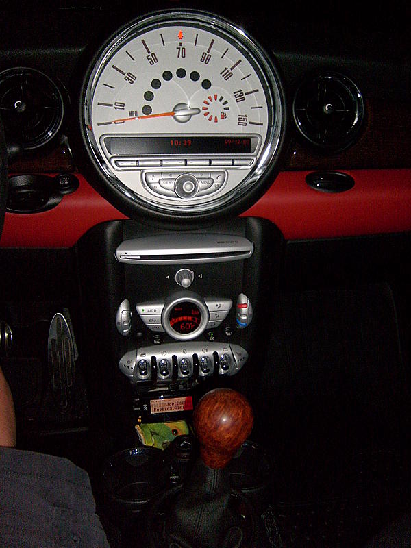

Sportscaster
I installed a Sportscaster in the cubby ahead of the cup holders. Fits well, tied into the "shark fin" on the roof using SMB male by female cable on the EBAY tied into the connector under the passenger seat. Tied into the fuse box with a "add a circuit" fuse adaptor for power and an voltage converter from xmfanstore.com. Sorry photo isn't any better, will try to send more.

Ditto that for me. I used two-sided tape and secured the unit to the underside of the stack. I used the mount for the Sportscaster by removing the suction cups. I also passed the aux plug thru one of the holes for the suction cups. Gave the unit a little more stability.
I have had it fall twice. Both were very hot days and the adhesive just gave up.
Still looking for a better way to secure it, but it sits very neat while attached. Solid sound, too.
