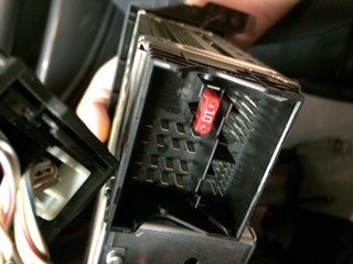

Can you post a clear photo of your wiring behind the HU?

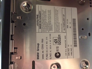

Radio pics
Got a chance to take some pics.
The part # is 65.12-6 961 275
Manufactured 05 February
Thanks again.

Harumph. Unfortunately the best way to confirm is to take your aux-in and plug it into another HU with a known working aux-in. If it doesn't work, you know the aux-in is somehow faulty. The reverse (plugging that aux-in into your head unit) would also apply.
Where are you located?
I can send you a known good aux-in, but if it's the HU, then you'd need to replace that next. I hate unexpected results!
