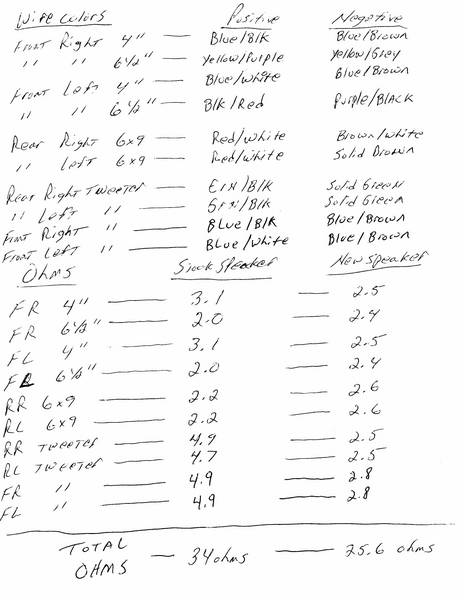

I've searched, but didn't find, a post stating the sizes of the OEM speakers for the HIFI Upgrade in the R56. Can someone tell me the size for each location? Thanks!

Here's something from another NAMer.

I believe the speaker sizes are the same for the standard and HIFI. The HIFI just adds tweeters. I can verify that the rear are 6x9s in the HIFI. I just removed them. There is a separate tweeter mounted in front of each 6x9.

Thanks, but I'd like to know for sure. Yeah, I can see the rears are coaxial.

I can't imagine BMW making different size cutouts in the door panels for the HIFI speakers. That just doesn't jibe with their cost-cutting concerns on the R56.
