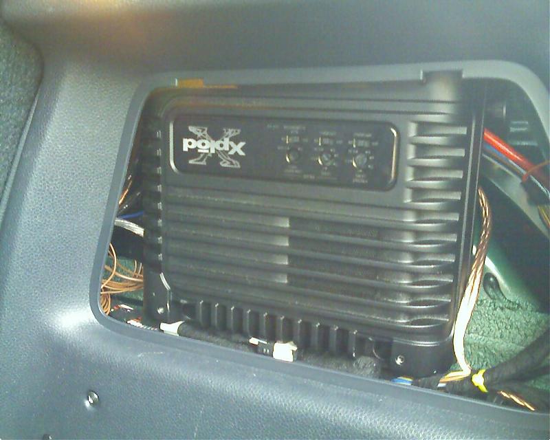

Here are a couple pics of the install. I will get a file pic of the amp tomorrow.

Here are some pics with the amp in place and the panels back on.
