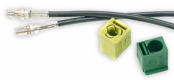

So, if we can find a male fakra to Sirius antenna cable, we can use the OEM roof mount antenna for Sirius...my search begins.

FARKA is just a keyed plastic shell over an ordinary SMB connector. Some can be removed nondestructively, others require a Dremel.
