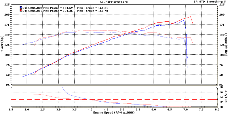

Another member did dyno test his JCW MCS with an intake. It was with MTH Tuner.

I am assuming that is before and after the MTH and Intake?

It was a JCW w/ Intake before and after MTH.

These numbers are WAY high compared to what people were getting at the SoCal dyno day. If these are wheel numbers, that 182 or so before MTH is like 10 whp higher than they saw!

Tradiuz-
You say this dyno picture is of a "JCW WITH intake" ...
The current JCW 210 and Upgrade (retrofit) kits come with a specific upgraded intake - in fact, it is the most significant part of the Upgrade kit, featuring a flap that electrically opens at 4500RPM to accept air from the cowl area.
Did the car tested here use something other then the JCW intake? If so, which one?
Are you saying that a car with the full JCW 210 kit actually 'needs' a DIFFERENT intake to make the biggest performance jump with the MTH installed?
I ask because I have an '06 MCS with factory JCW on order, and was already considering the addition of the MTH software. But, I am having a real hard time trying to justify the JCW as a 'performance upgrade' if the only way to add further performance is to start REPLACING parts of the expensive kit itself, instead of just supplementing it with additional bolt-ons (crank pulley, etc.).
Thanks for the info.

Mods on Vader at the Dyno's:
JCW, PROMINI intake & strut brace. Konig Holes wheels. Graphics by Eric at Artisic Signs. Lots of optional equipment
The only mod between dynos was MTH Tuner. The first Dyno was back in December of '04, the second was done July. There is a 60*F difference in ambient temps between the two runs (30-40* / 30% Humidity December -> 90-110* / 80-100% Humidity July). Thats why I am going to be doing some runs on the same day/time of day when the weather cools off (90+*F w/ 100% Humidity is bad dyno weather).

Tradiuz, what do you make of the a/f curves on the dyno sheet? The blue one (factory) looks to be lean and flat (which seems unusual for the JCW). The red line (presume it to be MTH) seems to go rich at high rpm's. Not criticising here at all, just curious about your take. No arguing with the results, they are very impressive.

On my 2003 JCW with the 210 upgrade kit, I didn't see much of a torque gain but about 10 hp increase. On all the post MTH tuner dyno runs there was a strange drop in power/torque at 6600 rpms. I also feel the same thing when driving. I can't figure out how to post an image or I would include a before and after graph.

I have a 2003 JCW with the 210 upgrade kit. With the MTH tuner file, I didn't get near the results of "vader" on the same dyno. This a before and after chart. The before was done about 8 months earlier on the same dyno. The only change was the MTH tuner file. I drove about 600 miles on the tuner file before the dyno run.

good to see that data....
I still would like dyno's to see MYTH find and run a JCW with pre and post MYTH install, same day, same ambient temps, etc.
... I would think it would financially behoove MYTH to go to a JCW owner receptive to a MYTH install and do a dyno pre and post software change.. and post results
validity concern that pops to mind is problem with dyno'ing a jcw with an jcw intake, as general dyno'ing seems to have a car with the hood up, and a large fan blowing in the engine bay... this obviously favors a car with an open air element or CAI.. the JCW draws air from behind the cowl...
This makes me wonder about the validity of all those dyno runs folks have done with ALTA, Rouge open air filters when compared to a JCW equiped car.. but I digress somewhat...
