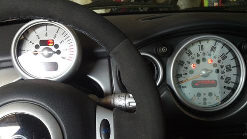

Finally got the belt Wed and the Alta pulley too. After battling with getting the factory pulley off, I finally got the Alta pulley installed and torqued to 85 'lbs. Then to get the belt over the final idler pulley, a little spit and the new belt is in place and lined up perfect.
Old Jul 7, 2013 | 12:03 AM
BLU-BY-U's Avatar
BLU-BY-U
Joined: Sep 2008
Posts: 997
From: Longmont, CO
Fenderwell and all are put back on, wheels are on, and he is ready to be started up, fingers crossed!

From: Longmont, CO
All good. All codes cleared, ECU is cleared and reset.
I did several "laps" around the neighborhood, about 6 miles worth, going easy on the RPMs at first then taking it up to 4k on the 2nd "lap", then 5k on the 3rd "lap" and then a little over 6k on the final "lap". The Alta crank pulley is pulling harder! The Craven Speed Blue Dip Stick is inserted too!
Very happy, and BLU deserves a wash now that he is all better!
