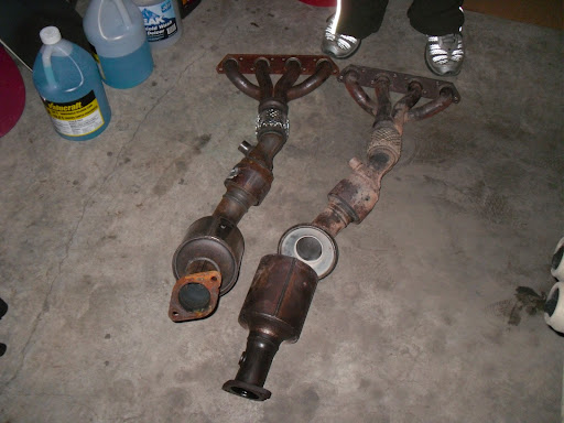

This perhaps?

I has same thing happen
Last Fall I had my factory header just fall in half as well. Different joint, pre cat can ahead of the one pictured.
After getting a used header from Clint w/ Defenders of Speed in CA., I put the 2 next to each other & could see that every weld on my original were faulty. Automated Robotic welds were evenly made but penetration lacked cold welds.
