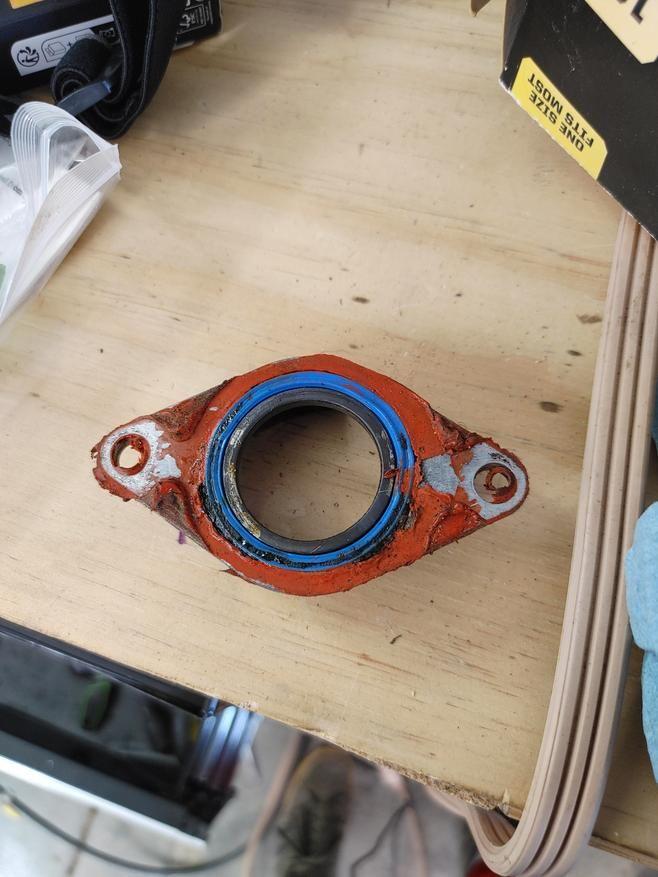

Replaced the crank position sensor, coolant sensor.
Servicing the supercharger ended up being a bit more of an odyssey then expected because whoever had previously serviced it over tightened the drain plug so it was stripped.
I took the PTO side off and drilled and used an Ezy out.
At least the internals look good on it.
Replaced the oil, the drain plugs with ECS magnetic plugs, gasket and water pump.
