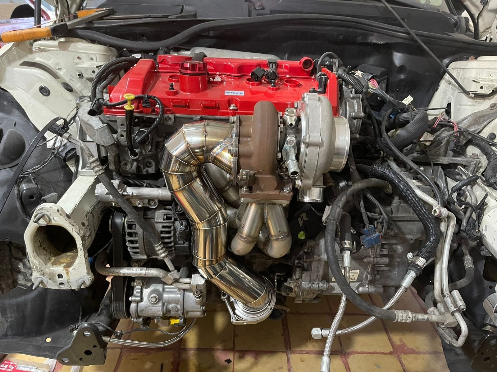

Hi
my engine N18
Mods :
FMIC
Charge Pipe
K04 Rev 9 F21 Turbo
NGK one step C. Spark plugs
AEM cold air intake
Forged Rods supertech
Forged Piston supertech
ACL racing rods Bearing
supertech headgasket
Downpipe
Straight Exaust
Silicone Hoses coolant radiator
(in progress ) engine block closing deck
New oil Pump
New Water Pump
New timing Chain
NEXT MODS
New clutch
New brake system
My question would be with these mods, what would be the best tuning and how many HP could I expect?
And if anyone has any advice or could guide me to get the best out of it I would appreciate it.

Reach out to @Lou@Prototype-R for a tuning solution. He will work with you to find the best options.
Old Apr 2, 2024 | 12:26 PM
Posts: 36,766
Likes: 2,552
Custom tune because of the larger turbo like noted above. Just watch with the cheaper turbos as they might have issues. Wastegates and leaks.

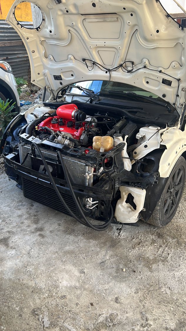

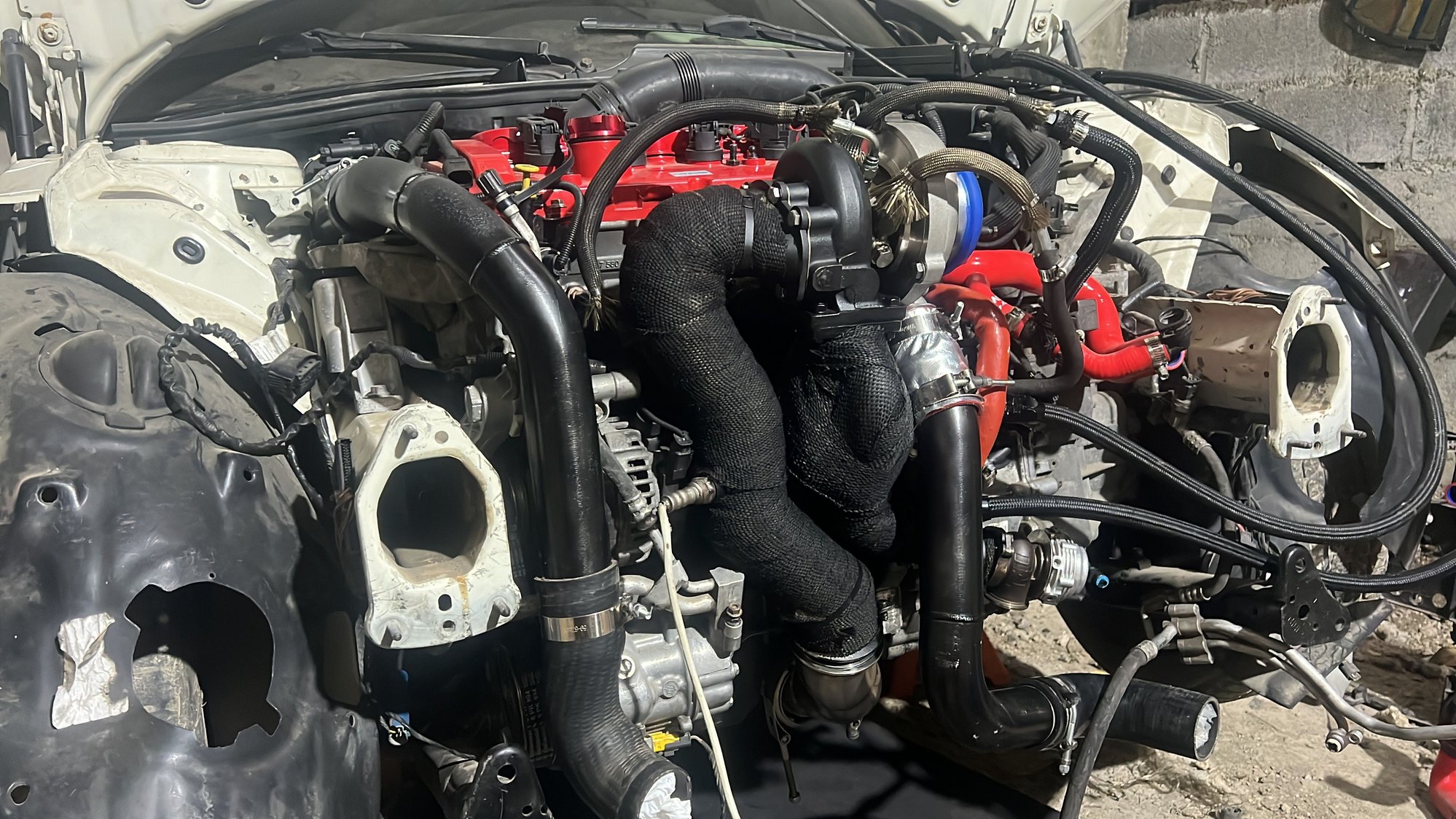

Update mods
Update mods
