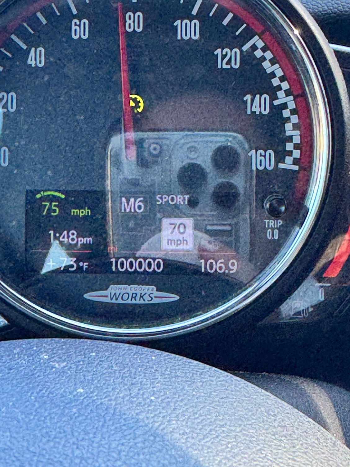

I kinda forgot this post existed but here we are two years later.
Major things
-first track day
-mileage crossed over 100k
I’ve been using this car as my daily driver and fun toy for the past two years and I am very impressed at how well it has aged. The odometer turned over 100,000 miles on New Year’s Eve 2024, very fitting.
The JCW is an absolute delight and I think it’ll be apart of my garage for the foreseeable future. Not super impressed with the new generation offerings from Mini.
Now for the questions:
any big ticket maintenance items I should watch out for going forward?
-I am aware of the oil filter housing gasket and water pump.
any ideas for modifications or fun things to do with this car?
-reliability is my primary concern right now until another daily driver is procured.

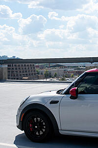

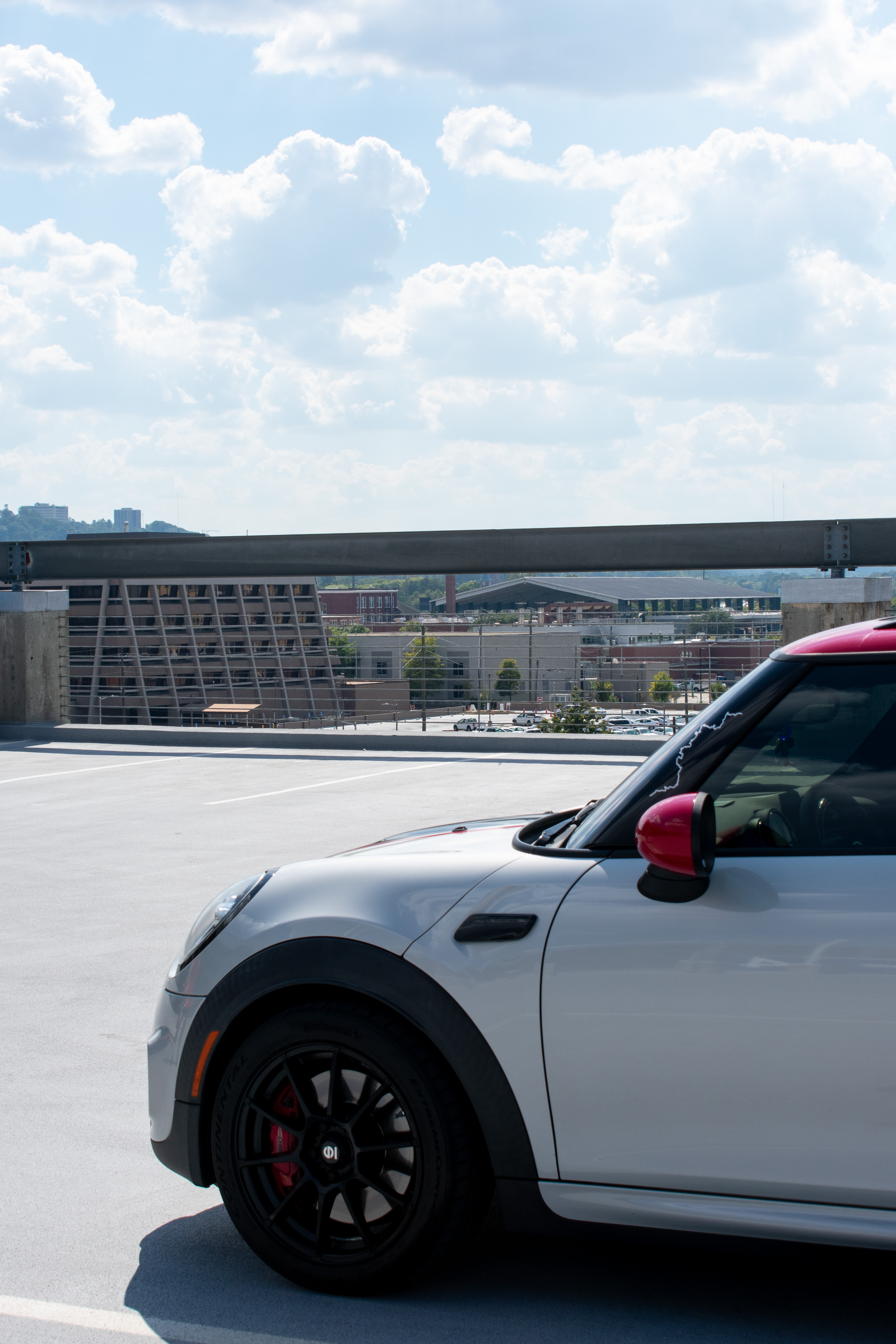

First track day | October 2024
Mileage turnover 12/31/24
