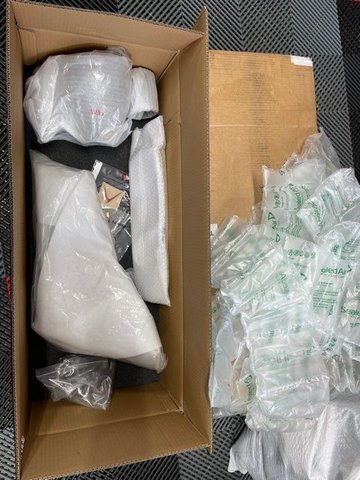

Eventuri Intake
Well today I got a surprise and my Eventuri intake showed up about 8 weeks earlier than they said at Outmotoring. This guys so far have been awesome to deal with. I got the cheaper (yeah not cheap) non CF version as I do not plan on showing my car so no need for the CF inside. I will say the product is top quality for sure. Even from the packaging and care they take I will say it was a nice touch. With taking pictures the install took an hour and most of that was on the hood scoop. Super easy to do. Here are some before, during and after photos.
You can see how it was shipped. Tons of bubble wrap etc.
