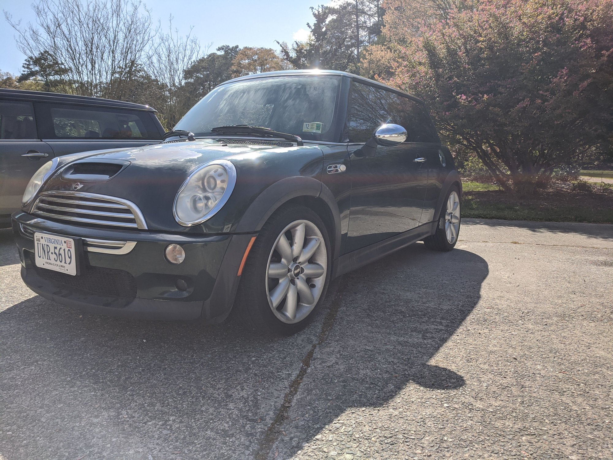

Some may be familiar with the phrase “shaving a yak” and some may not. For those who aren’t familiar with it, I shall explain. Yak shaving refers to a task, that leads you to perform another related task and so on, and so on — all distracting you from your original goal. I think we’ve all been there at one point or another. How hasn’t uttered the slipperiest phrase in car wrenching, “well, while I’m in here”? This is my approach to car maintenance. I start with something that morphs into 20 side projects that ultimately results in the resolution of the original 30-minute job in approximately 3 months’ time. I am a yak shaver. I’m not proud of that, but I accept that is what I am. Apparently, that’s the first step to recovery. Too bad that I am a procrastinator and will probably not move on to the next step.
I’ve owned many cars over the years (50+) and have always like Coopers but was hesitant to pull the trigger by the horror stories I’d heard from others. About two years ago, I bought an R55 Clubman that I did way too much work to and ultimately sold to buy my 2006 R53 Cooper S. The R53 has all the bells and whistles I want, but (sad trombone) it is an automatic. That is why I bought it. The previous owner had already done sacrifices to multiple deities and yet it had a persistent issue with a hard shift from 1st to 2nd. I think his next step was to offer the car to Regin, but I intervened and bought it for 3 figures. Not a low 3 figures, but still less than $1,000. Here she is, my BRG 2006 in all her glory.
