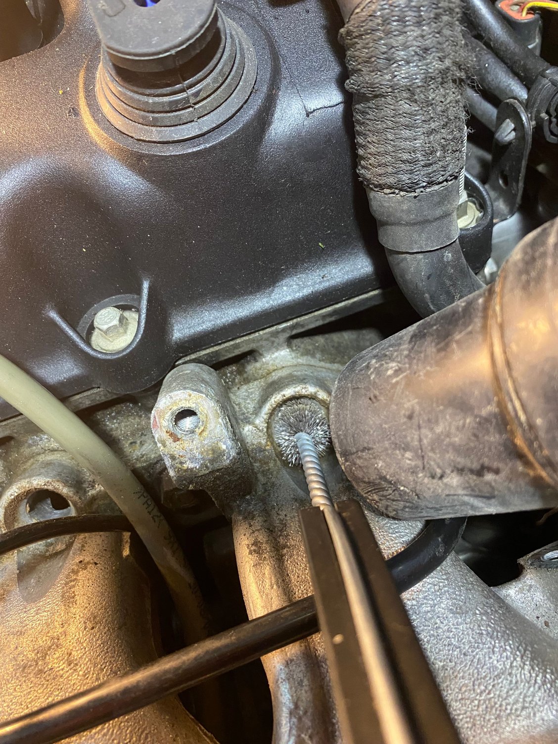

I was quite concerned on how to clean up the rust and crud from the manifold without getting any crap inside. I found that an internal wire brush, [used for cleaning 1/2" copper pipe prior to solder] was the perfect size. But was super paranoid about a wire bristle getting inside. I put a shop vac right next to the opening, "screwed" the brush in a tiny amount then quickly pulled it out. Did that a number of time going in a little further each time. The brush was almost new and I'm very confident no bristles were lost and no rust bits in the manifold.
I think they ended up clean enough. Some silicone grease should seal it up.

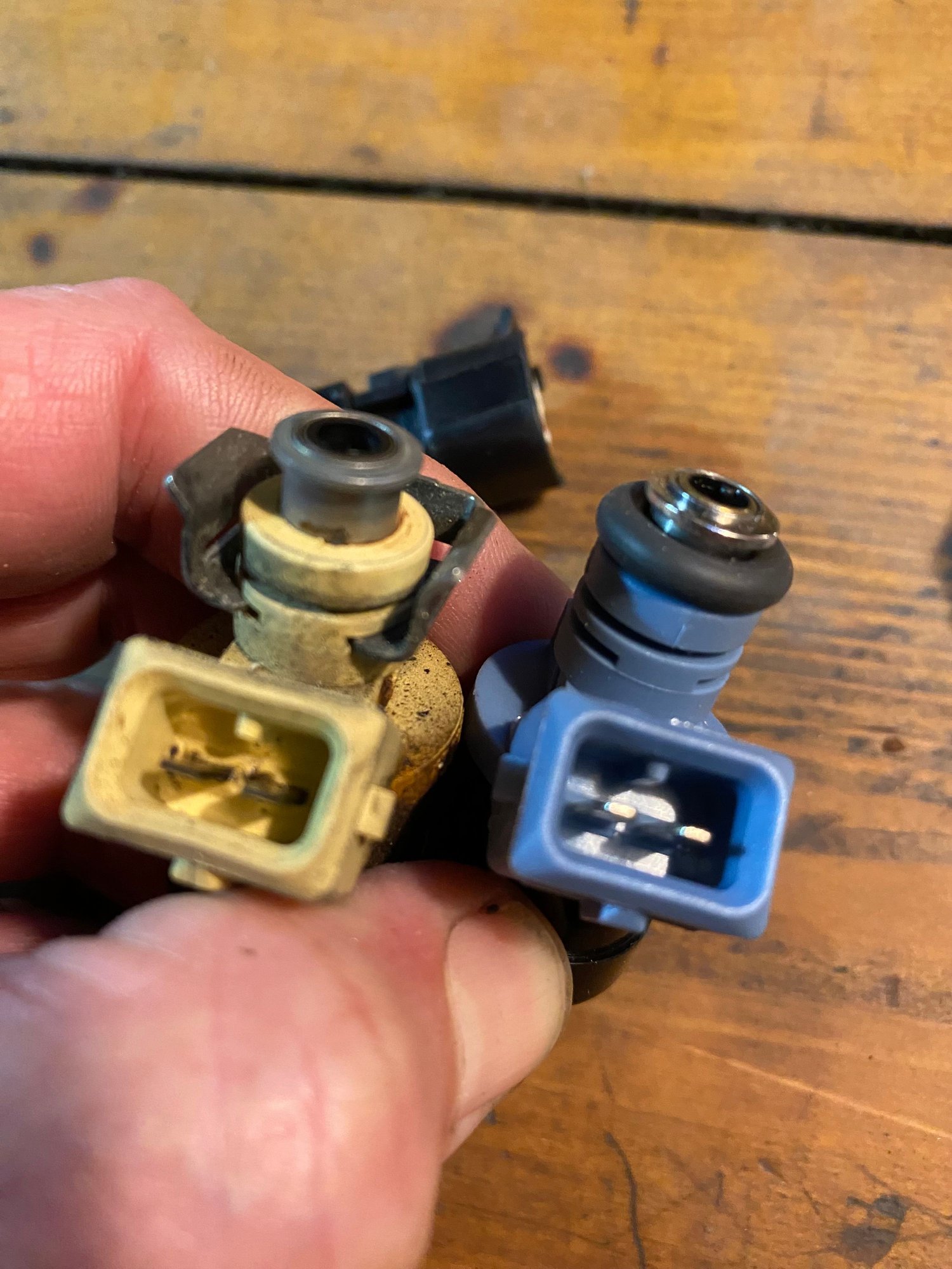

I had bought some 380cc injectors, [blue #0391511] a while back but never installed them so I'm thinking now is the time.
For some reason I was thinking I had the old injectors out but maybe not. So after almost 20 years and 169K miles, no wonder they were stuck!

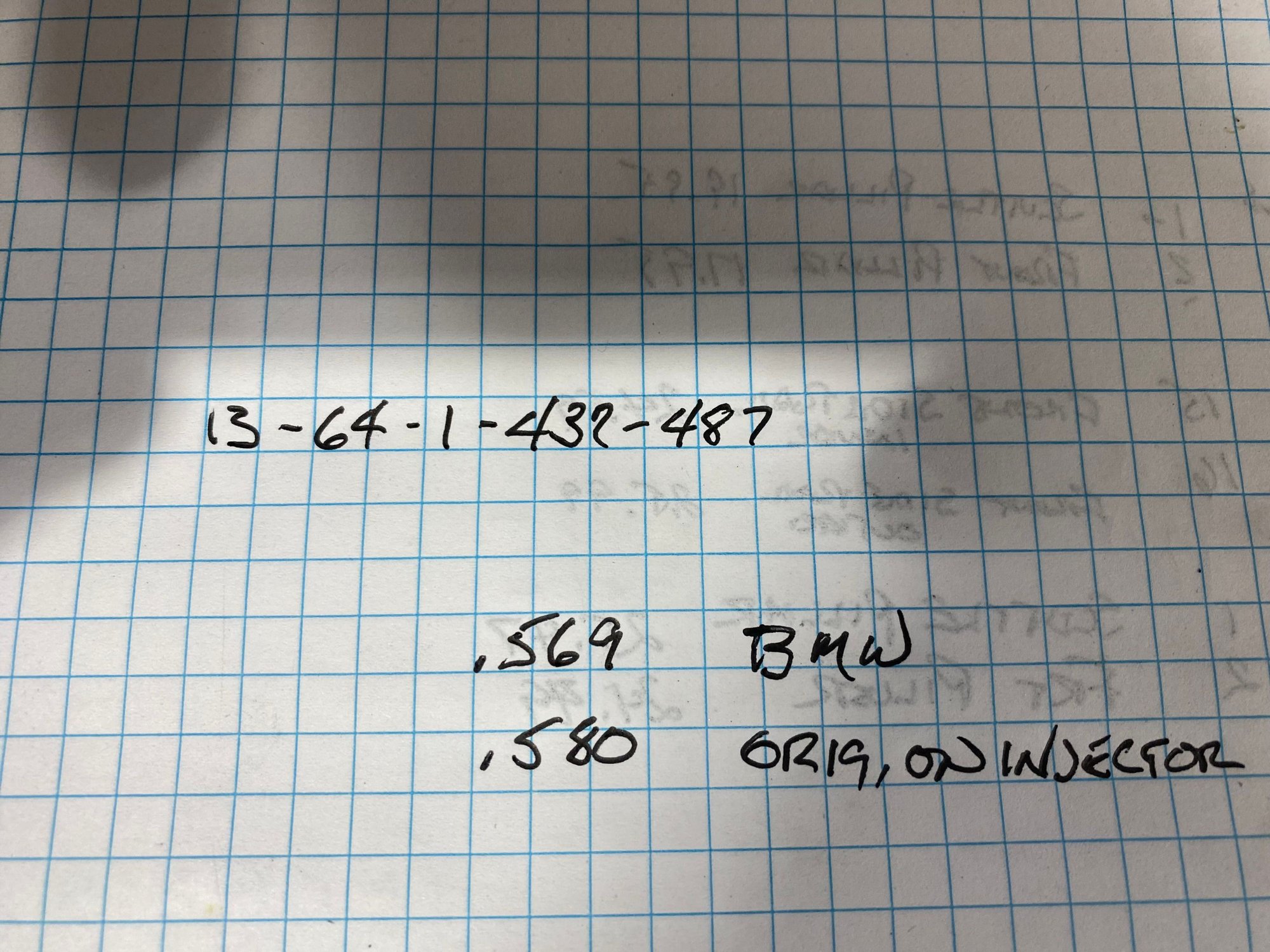

At the same time I bought OEM O-rings as I recalled reading the blue injector o-rings were a little larger. I checked the and that is the case.
[For those interested a rubber o-ring is pretty hard the measure with a caliper. What I do is lay them flat, tighten the flat part of the caliper to the o-ring enough to pick it up, then open the caliper very slowly until it drops and that's your measurement. That's what I do, your results may vary...]
Not much of a difference but maybe enough to give you a fight...
I think I also read somewhere that adaptors are needed for connection but maybe that was for some other injector. I had bought them but the connection looks identical to me. Then I read last night these were the injectors used on the Works Minis.
I did have some small corks left over from something. Can't be too careful!

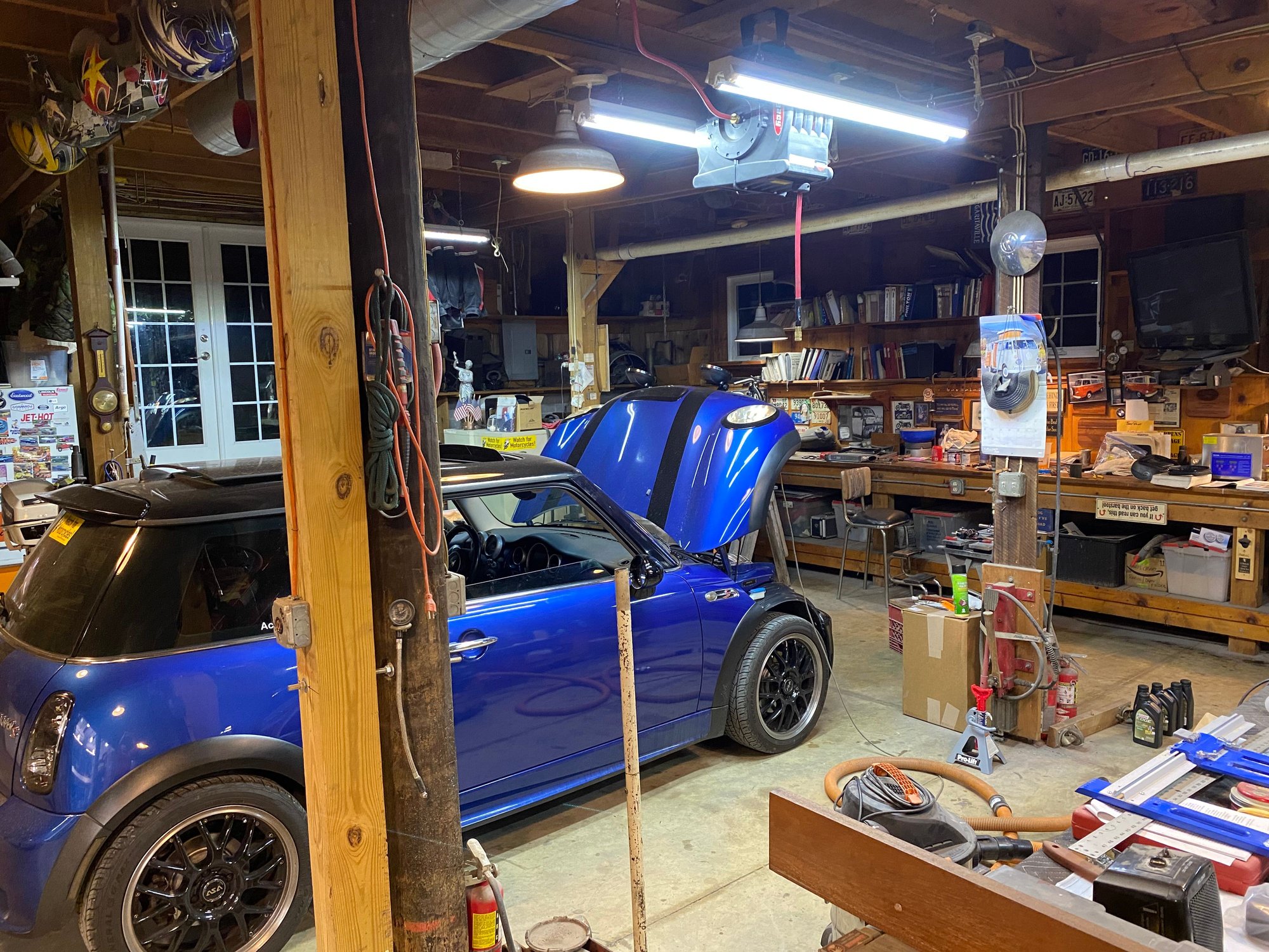

The VW is a bit of a one off. Originally 1700cc now a new/used 2000cc block, new pistons and barrels, cam, balanced, blueprinted and of course those beautiful Dellorto's. A guy in California, "Steve Noll" did the balance and blueprint on the block. Might be able to actually pass 1 or 2 people. Shame it's all going to be hidden under the back of a bus.

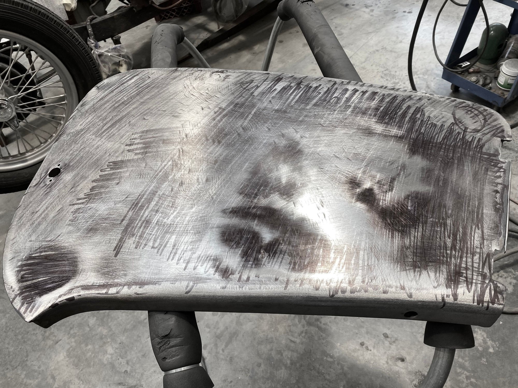

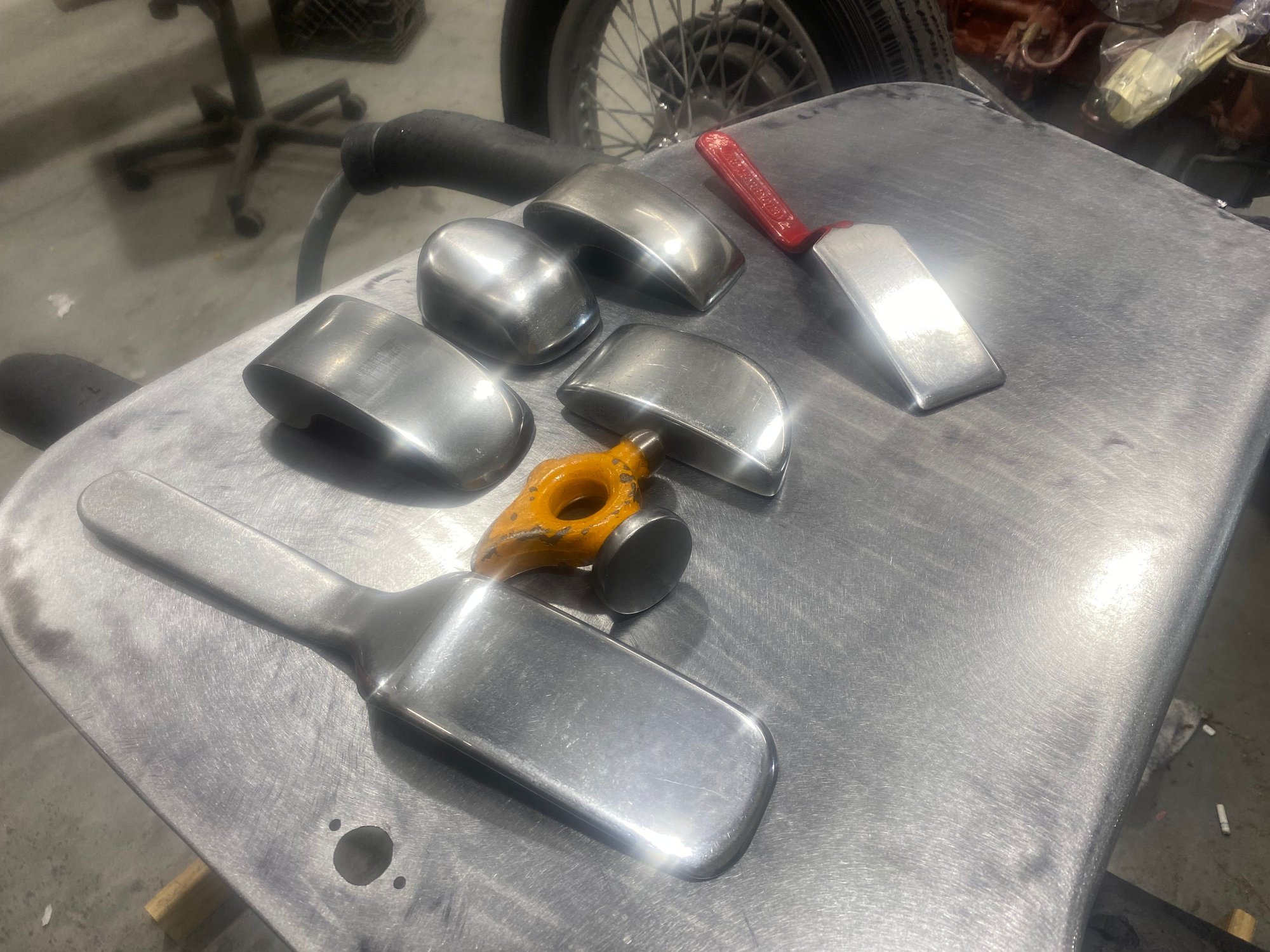

The MG. Spent probably 70-80 hours getting the door skins straight enough for pretty much no filler. And still working on door #2. Some patch panel work as well of course in areas it was the most difficult.

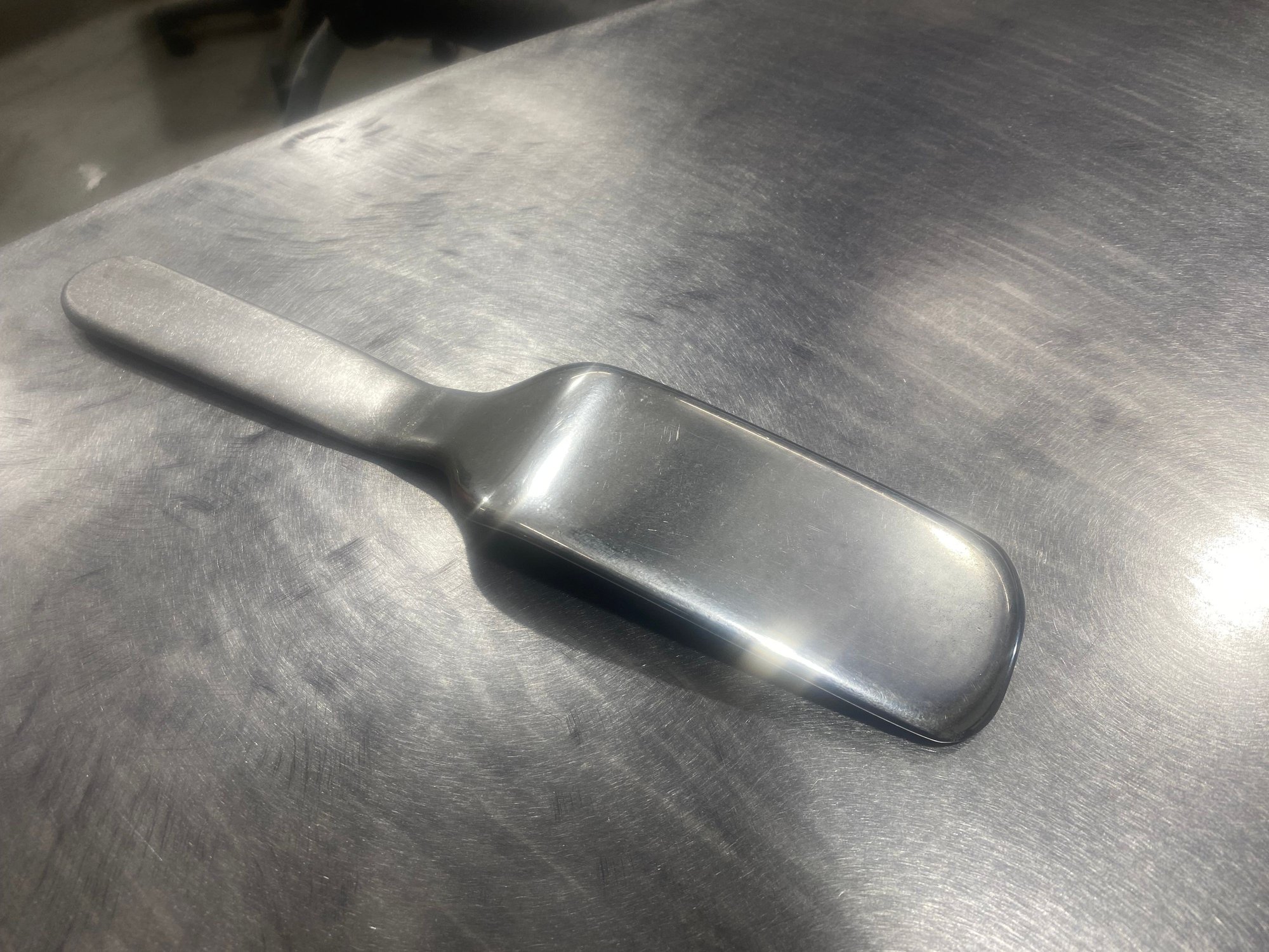

Ended up making a "Slapper" from a piece of leaf spring when I couldn't find one I liked.
That, along with various dollys and a "Shrinking disk" made for some long but interesting evenings.
To be honest, It was nice to get to work on the Mini where things are just bolted together and not as much "artwork" is involved...

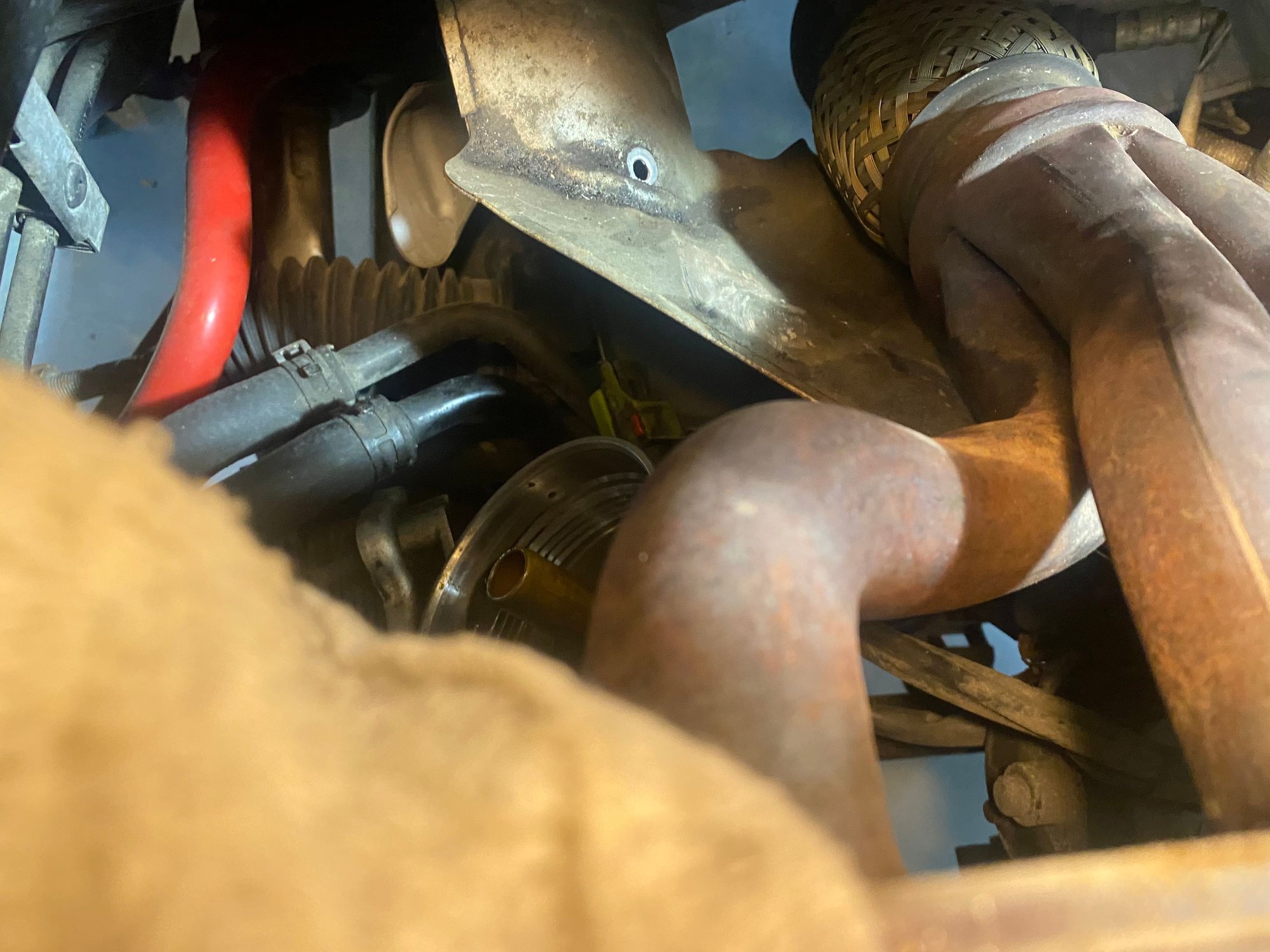

So the Mini. It looks like the oil leak is in fact the oil filter housing base, which you pretty much can't see from the top or the bottom. I was hoping it was the valve cover gasket so I bought one of those as well but although there were some tiny leaks at the bolts, that wasn't it.
However, I do have to say removing the vale cover gave a tiny bit more viewing and working room and every little bit counts with this job. What a PIA!
This video helped but to be honest I couldn't get the lower of the 3 bolts from the bottom like he did. I got them all from the top and I "think" removing the valve cover is what made that possible.
Of course I haven't got the parts yet so reinstall is still up for grabs. It seems to me that BMW is not so great when it comes to their "sealing practices". It took about an hour to get the bolts out even after everything was removed.
It's down there somewhere...
We'll see how it goes once the parts arrive...

I went in from underneath/the RF wheel well when I resealed Grumpy's. Doing it at work on a lift was a big help, though. Mini is thinking the same thing as parent BMW: job security for their technicians! 🤣 Oil leaks help me pay the bills!

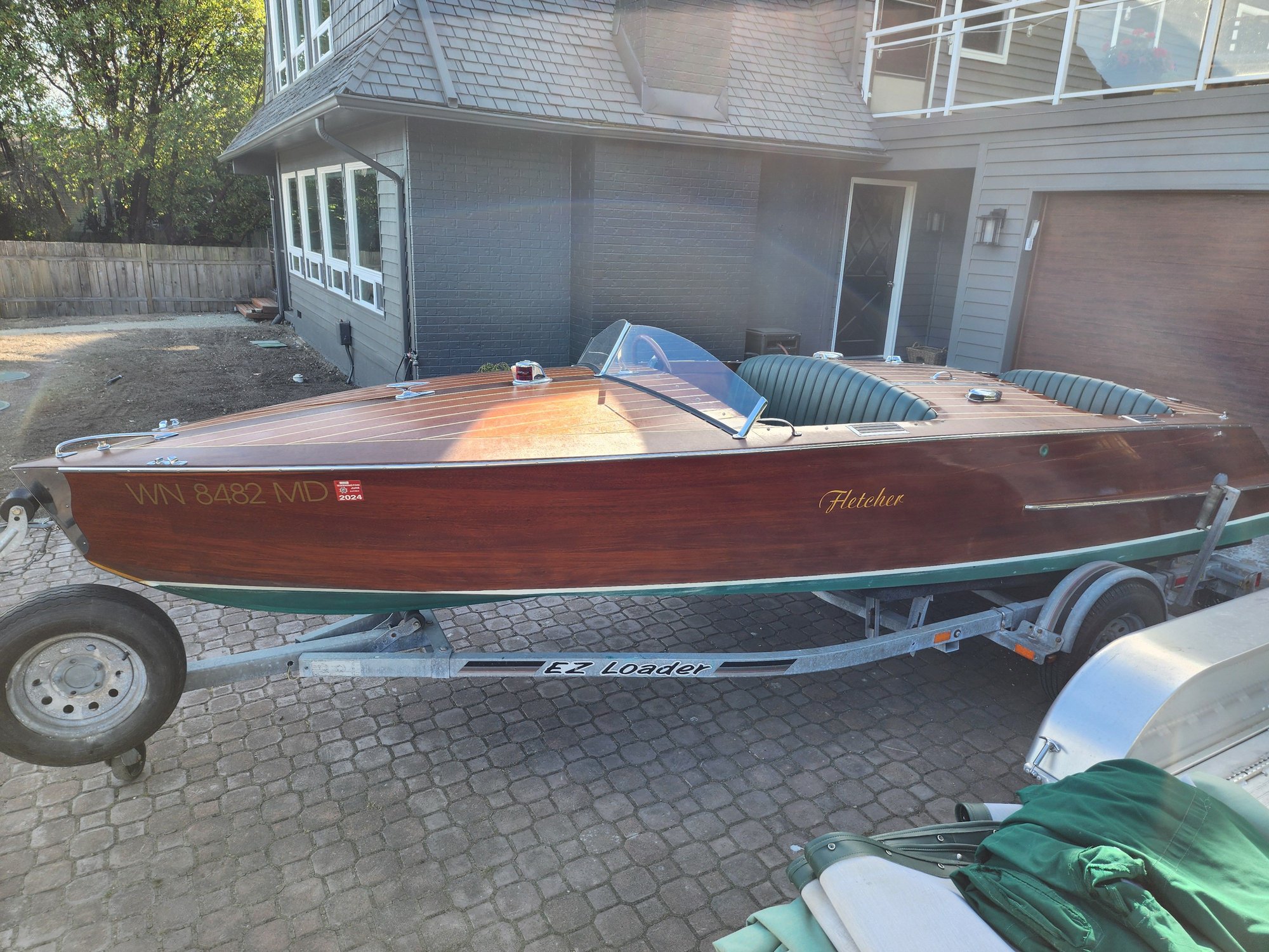

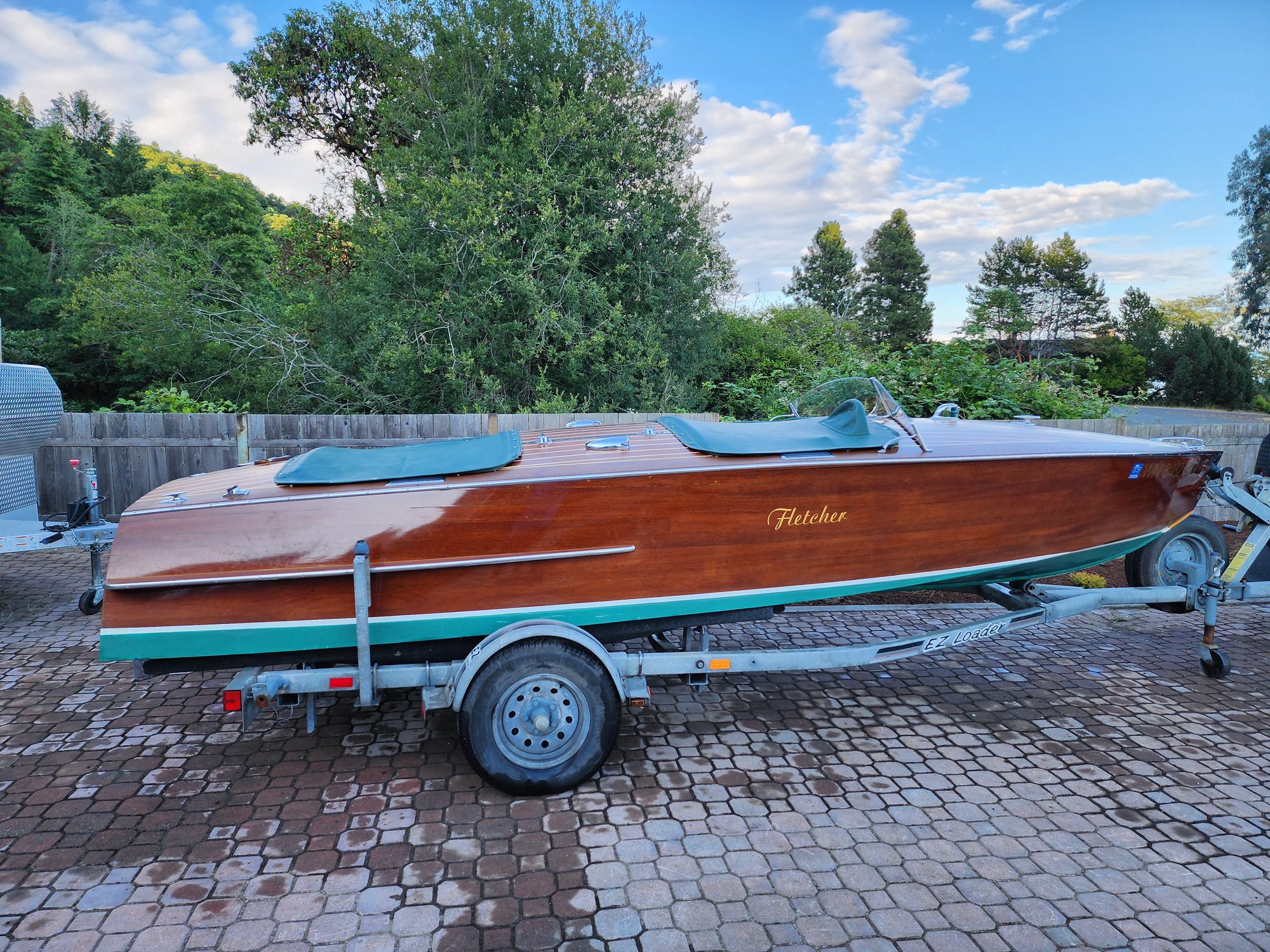

Just scrolled backwards through 21 pages of this thread looking for pics of the Chris Craft. I couldn't remember much about it. Mainly for an excuse to show you my new toy that will soon displace the Mini in the garage.
I was working the Mini toward full track car status when I realized that would be another hobby that took me away all weekend, and that my wife would not enjoy.
We moved about a year ago to an island, and the boat launch is literally 5 minutes from my house. I can be cruising 30 minutes from hooking up the trailer. I've always loved the old CC runabouts so I started researching.
She is not a Chris Craft, and she's not really that old. She was built in 1993 by a gentleman named Simon Fletcher in Port Angeles WA. He custom built 2 boats/year for about 30 years, with the idea of creating classic looks, with modern tech. She's full mahogany, but put together with epoxy, so no-soak.
We are loving it. This winter she'll get a complete Beaty treatment. The wood is, in excellent shape but needs to be revarnished.

Wow, How did I miss this? That there is one very cool looking boat! What engine?
Varnishing is a fun wintertime project. I can sometimes be challenging but that's the fun, [I guess]. What I used to do, [on pieces, not an entire boat] is keep doing coats until one looked really good then stopped.
You're not going to bare wood are you?
