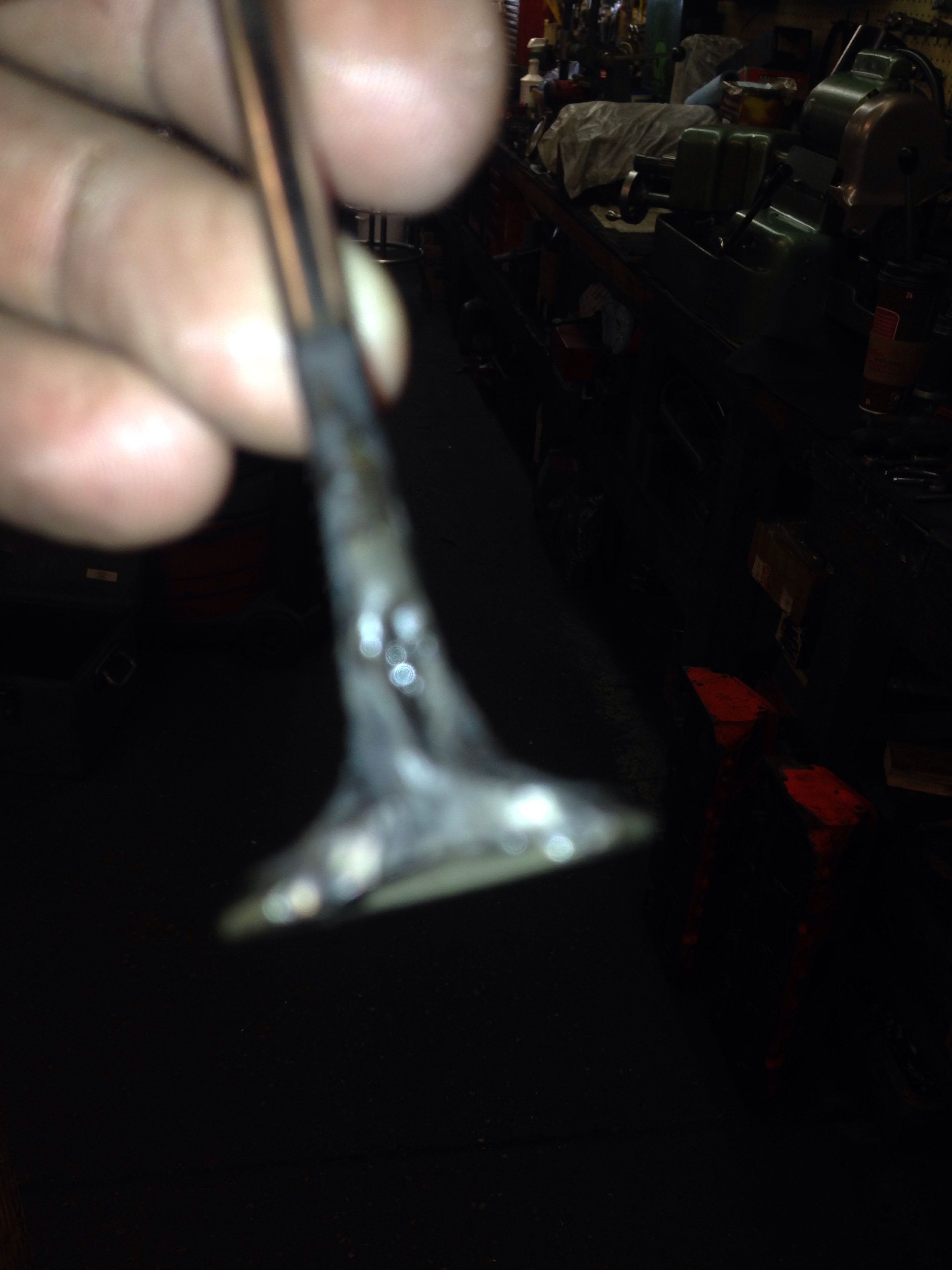

K I have a novice question, aren't the stock valves sodium filled? If you had installed the aquamist kit, would it have been ctastrophic to have water introduces to sodium? If I remember right you changed the valves correct?
Also what CAI system did you go with and did you have a front strut bar with it?
The valve stems are sealed.

Tigger 2.0
Stock valves are sodium filled.

Tigger 2.0
Figures the blurry photo would post. Well, you can kinda see were the hole is in the stem were the sodium used to be.
