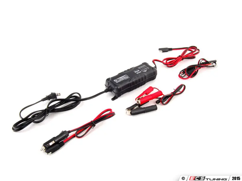

The battery is under the cowl and with some small alligator clips you can reach it under the cowl flap. You can also buy kits that have little eyelets to add to your battery terminals and then connect the little plug that connects to the alligators. Then you just plug it when the car sets. Tuck the wire back in box when not in use and you dont have to use the alligators.
https://www.ecstuning.com/b-schwaben.../005979sch01a/
Take the cowl out on the one side and you can reach it and it comes out with just a bolts and a plastic nut and snaps out.
Most charges have a built in systems so they dont reverse polarity https://www.ecstuning.com/b-noco-parts/
I run one on my R58 and use my on my R52 all the time when stored.

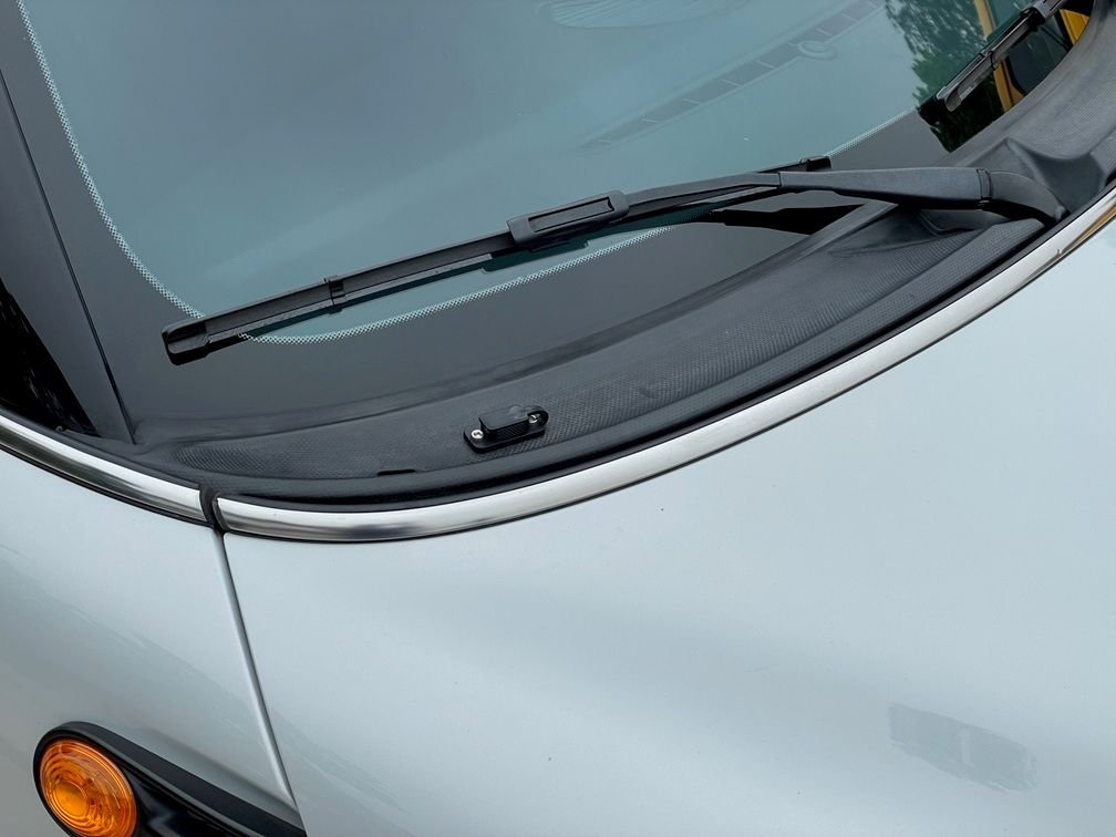

Here is my solution to connecting to a trickle charger using an inexpensive connector. Perfect fit since its also just above the battery.
That's a cracking idea! Will have to fit one of those myself.
