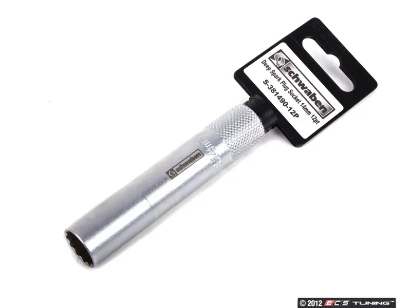

Problem is, i don't seem to have a socket that fits. 15mm is just barely too big & slips, 14mm too small.
​5/8 plug socket doesn't fit either.

I can check when I get home, but I'm sure that you need a 14mm thin wall 12 pt. Check with ECS
Old Oct 22, 2024 | 07:51 AM
Posts: 36,744
Likes: 2,541
Yep take that special thin wall. Most plugs are the 12 point unless you get a brisk plug, but most of their plugs are now the 12 point for MINI. Use to be 6 point. Some people like the swivel head version. I used both on my Gen 2 MINIs.
https://www.ecstuning.com/b-schwaben.../001247sch01a/
https://www.ecstuning.com/b-schwaben.../026717sch01a/
