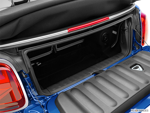

The backup camera on my 2022 Sidewalk Edition convertible only works when it knows the rear trunk lid has been properly closed. Unfortunately, that seems to require a very firm slam when shutting it, so I'm wondering if the lid open sensor is consumer-adjustable? I'm not even able to find such a sensor, so wonder if anyone else knows where it is located, and whether we can adjust it?

Their is a microswitch on the storage self also and you have to make sure its on the sensor.
61317442644
https://www.realoem.com/bmw/enUS/sho...34#61317442644
https://www.realoem.com/bmw/enUS/sho...diagId=51_3825
Looks like so sensor anymore push button on the trim for the trunk for the lid
So it looks like its the lock themselves in the trunk lid that tells the system its closed.
Diagram of trunk: https://www.realoem.com/bmw/enUS/sho...diagId=51_3889
Locks on trunk lid
https://www.realoem.com/bmw/enUS/sho...diagId=41_1916
https://www.ecstuning.com/b-genuine-...t/51247195099/ Left side lock
https://www.ecstuning.com/b-genuine-...h/51247195100/ Right side Lock
Possible the dealer can just adjust them?
