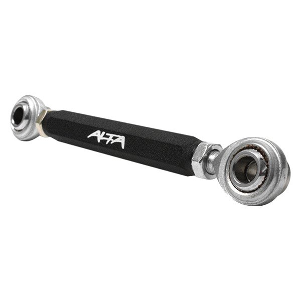

I have an adjustable rod in place of the little shock that is usually on these tensioners.
Would swap this out with a factory style dampener listed above and see if that clears up the sound. Mixed reviews / experiences with the adustable rod on this site, would research and proceed with caution in continuing to use one.

I tried getting a video but the noise didn't come through on it as well as I would have liked. However, I did some stethoscoping and I do believe it is from the tensioner idler. Mine does not have excessive movement and it is also worth noting that I have an adjustable rod in place of the little shock.
This was in place when I bought the car and I have not experienced one with the shock installed. If I am not mistaken, I think the small shock is what fails on these and causes catastrophic damage to everything around it, so I should be safe there at least. The potential downside is that I have to tighten the belt quite a bit to prevent slippage under moderate accel with this configuration, which would also put more strain on the pulley bearing. I assume that the standard setup on these tensions the belt under accel in the same conditions.
