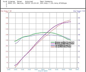

I can't answer your question because I'm still an R53 noob, but it's also a topic I'm interested in and I have the same questions as you.
It'd be great to have dynographs from the same car but with different cams installed as that'd really give a solid idea of what to expect.
The closest to that I've seen is this one:
Found on a BVH thread but cam talk also,
here:
https://www.minitorque.com/forum/f24...ml#post2229282

There's a hard to read dyno chart on WMW link showing torque gains from 2500 and up, and peak power from 150 to 172 HP.
Yes that was a totally independent dyno done by a customer in CO. The baseline was his car with just the 15% pulley, then the 2nd line on it is with the ATI stock size and our mild street cam. The shop there was a porsche shop that did the install and dyno tests so I like that I was not involved to be accused of fake or fudge the numbers on it as some people do. I'll even admit that dyno shows a little bit better gains than normal, but each car does react differently. I like to say dyno graphs aren't really important to show gains in the form of numbers, it's really looking at the comparison of the before and after to see that there are actual gains and how the curves change. Because that is how gains should happen to each car as every car is going to be different on what HP number they have, and then what they will have after.
Originally Posted by IQRaceworks
For a shop that does this on a regular basis....I'm surprised way motorworks doesn't have any before and after Dyno graphs he can post up.........
Not really as a shop that physically works on cars on a daily basis we are busy working on real cars every day so having time to go to a dyno for a single test takes us away from the shop when we are already scheduled out weeks for appointments. Also most people that do a cam don't just do the cam as we often do a package of mods and repairs at the same time. So posting dynos of cars with a bunch of mods done before and after isn't going to be an accurate representation of what the cam will do on it's own. That is why the dyno we have posted on the page is there as it is the closest rep of the cam gains on it's own. Normally we do a cam when doing a head repair or timing chain job which the car isn't running right to begin with so that doesn't create a good baseline. Or we will do injectors, cam, head, and header all together and again that will show gains for everything not just a cam.
We did dynos long time ago before we offered our cams to get what we wanted out of it, but that dyno shop changed hands and the original dynos were lost. I've tried to source them from my failed laptop without luck.
