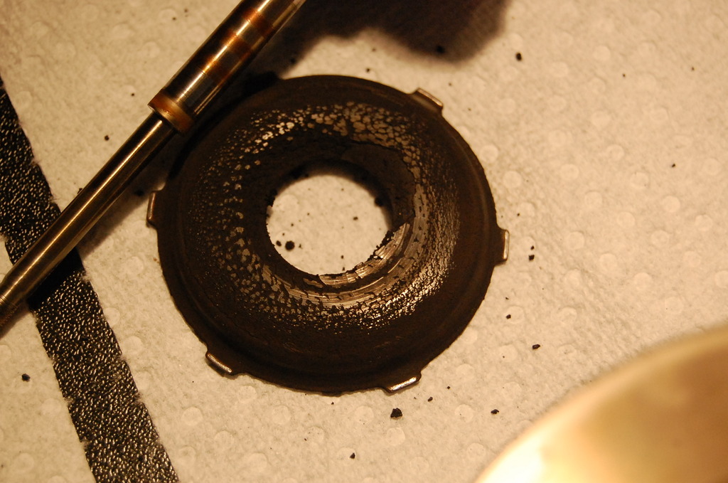

Originally Posted by tag1260
I guess I should have asked this first but how do you know if you need it to be replaced/rebuilt? What are the signs?
There are a few indications starting with a dentist drill type noise when at high boost. Second is white / light blue smoke which would indicate an internal oil leak. Third would be loss of power / boost which probably would also light the MIL indicator with the associated engine codes and lastly, external oil or coolant leaks but these would be due to failed oil or coolant lines or banjo fittings so not really calling for turbo rebuild.
On mine, which had 200k on it, I suspected an internal oil leak as I was getting some smoke intermittently. So I pulled it apart and replaced the seals and the bearing as well as the oil feed line. I found it coked up pretty bad so it was due and it runs much better now with very little whine on spool up, about normal in my experience. My turbine was loaded with carbon! It took a long time to remove but I'm sure it is more efficient and certainly lighter now.
Thanks. How did you know the line was coked up?
The line wasn't coked up. It started to leak at the banjo fitting the minute I touched it so it had to be replaced. The coking I was referring to was behind the turbine on the heat shield. You can see the buildup of oily carbon that the turbine was rubbing against. I'm sure that it was stopping the turbine at low throttle openings.
