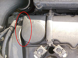

This picture shows the area of the oily residue (in retrospect, it was taken from the worst possible angle to see the oil, but it congregates down in that valley and to the rear around what looks like a vent).

A half quart for 1000 miles of driving seems a little much given you have an N18 engine, normally they burn very little to none at all. There's only so many ways oil can enter the combustion process, valve seals, head gasket, piston rings, intake tract from the turbo. It's possible oil is dripping onto the exhaust externally from the valve cover gasket or a crack in the valve cover, do you see smoke coming out of the tail pipe?
Under that cap thing you couldn't get off is a rubber seal with a spring. Seems to be a pressure relief of sorts. Don't try to take that small cover off, the tabs holding it on will likely break, mine did. That plastic is thin and brittle. Not sure if that's any help, just an fyi.
My '07 N14 MCS had a similar problem, oil use and bad smells, caused by my mods --- OCC and blocked PCV line to the manifold (which isn't on the N18). My positive crankcase pressure was causing oil to get thru the turbo oil seal into the turbo air inlet chamber. This can be verified by removing the turbo air inlet plumbing and examining the inlet for oil residue. It's supposed to be dry. If not, since your "up-stream" air inlet hose is "comparatively" dry, the turbo oil seal would probably be the source. This doesn't mean the oil seal is shot, it just means oil takes the path of least resistance. I fixed both oil use and smells by re-connecting the PCV line to the intake manifold.
Chances are, your valve cover PCV system is faulty. There are other causes for positive crankcase pressure, and all should be checked before replacing anything --- a compression / leak-down test is probably the best test for this issue --- AFTER you check for oil in the turbo air inlet.
Keep us posted with test results ---

Thanks. Definitely stopped pulling on that once I encountered enough resistance to guess that it probably wasn't supposed to come off on it's own.
I will pull the intake hoses and possibly the intercooler (depending on how much free time I can scam) this weekend and see what I see. Hopefully this can just be corrected by replacing the valve cover. I may do a compression test as well, but I'm not that worried about piston rings or valve seats considering that the engine runs so well and the fact that the car only has 26,000 miles on it.
