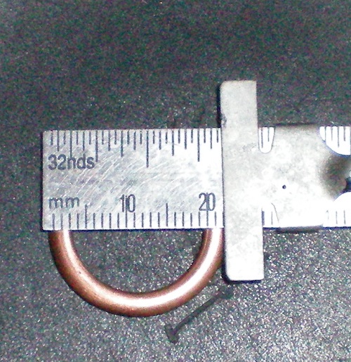

if buying from autozone
the crush ring has an outside diameter of 22mm, a thickness of 3mm
because of how the bung fits INTO the pan .. you can't get too sloppy on the fit ...
