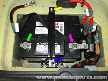

Old Jul 3, 2014 | 06:28 PM
DATBILLO's Avatar
DATBILLO
Joined: Dec 2013
Posts: 100
From: Delaware
The nut for green arrow.

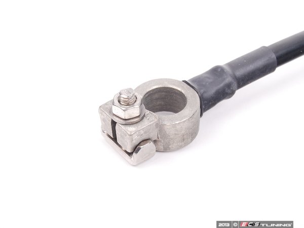

There are tow different cables, One is a straight post and one is the side post ( like seen in many R53 pics), where the cable comes in and made a 90 degree with the post.
Battery Cable Neg - part # 12427515200 Straight cable post.
http://www.ecstuning.com/Search/SiteSearch/12427515200/
Battery Cable - Negative side angle post. Part # 61121508937
http://www.ecstuning.com/Search/SiteSearch/61121508937/
Pic here
We tried before to find the T from the VW side but it was reported it would not work. So you have to get the whole cable.
