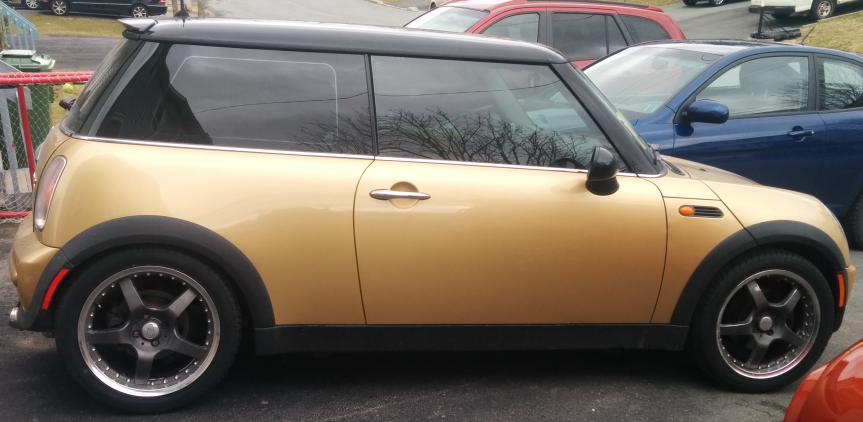

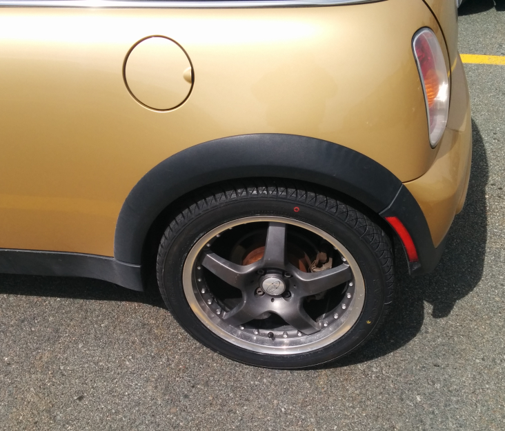

Here are a couple of pics of the S.
<snipped>
I'm feeling the yellow, and S won't have that risky 5-speed right?
Last edited by clicker666; Apr 13, 2014 at 06:25 AM. Reason: Ended up not going with the yellow, do deleted the pics.
The yellow 2004 S looks OK, it's likely that the clutch has been replaced, if not it's near to needing it done.

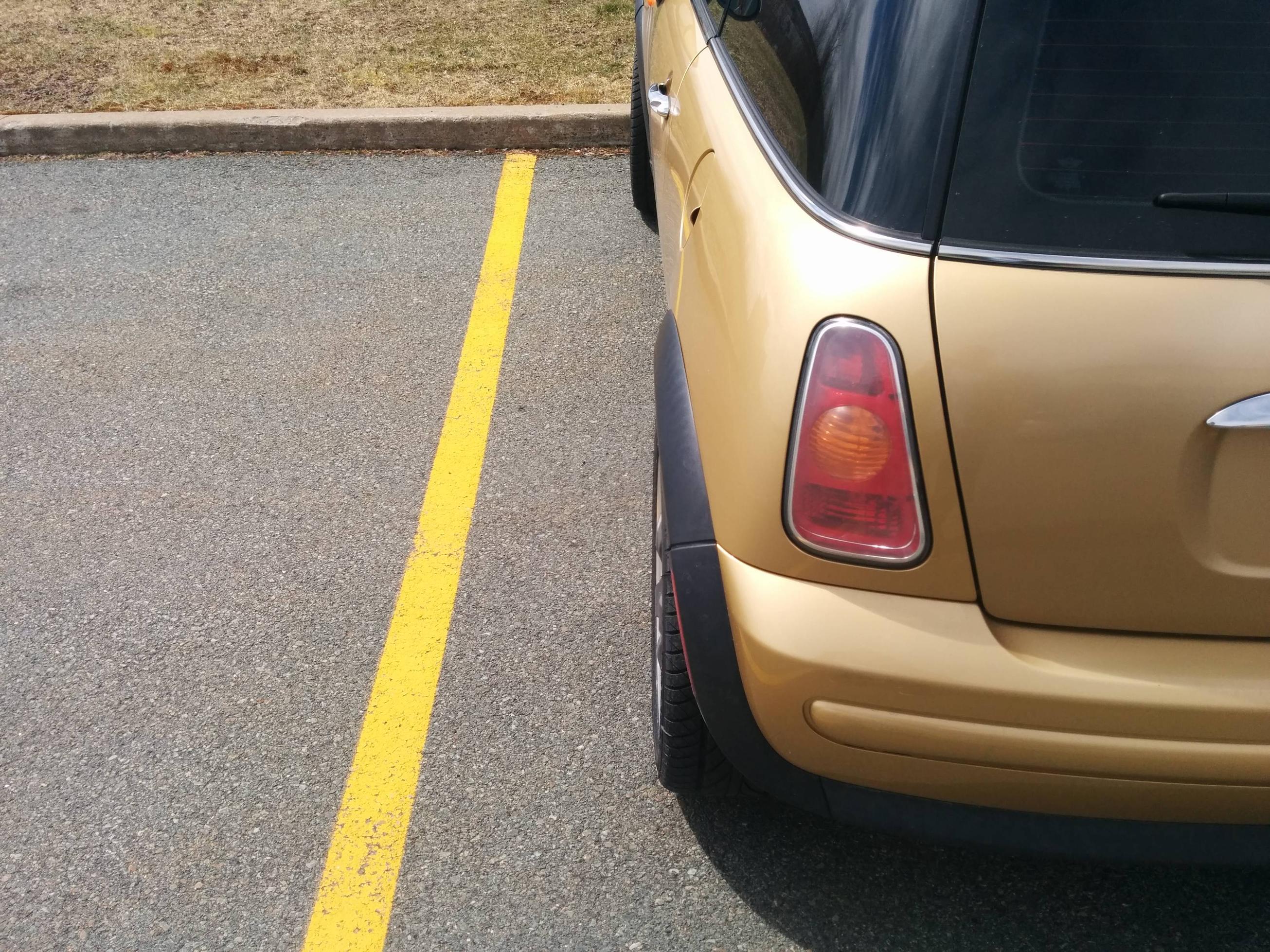

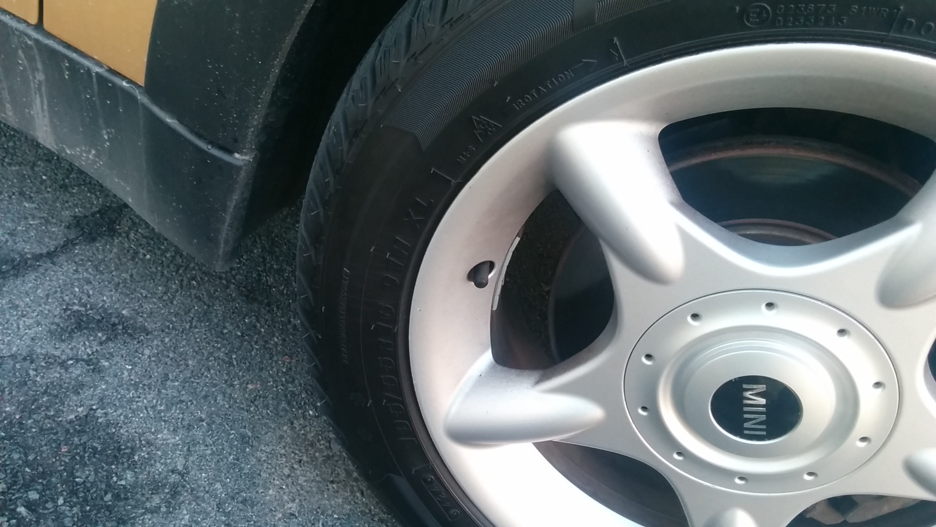

The yellow guy didn't call back and I took home the R50. The wheels are 16's and have 195/55R16s on em, they appear to be R83's (so are about 20 lbs a piece). They're winter tires, so they'll have to come off. I notice there's a tire pressure button in the car, so that means TPMS. boo.
Looking at the rubber I can see on this wheel I think I'd be happy with the 16 inch setup with a new lighter wheel. I'll get the sensors pulled out of the wheels when I get the new ones on, and when I have a few more bucks after the wedding I'll get some and throw them in the winters. So, 16x7 et42 was discussed above, which should push the wheels out further, add a half inch of width, and still give me decent rubber. What tire size would you recommend considering that I still want to minimize wheel gap? The gap that's there now really doesn't look that bad, and with the wheel pushed out the 12.5 mm extra that will likely help it *look* as if there's less gap.

I don't think you have TPMS, that was from about 2007 onward.
It's just a flat tire reset button.

Here's the end result:
They don't stick out too far, fill the gap nicely, and the wheels only weigh 16 lbs a piece. Tires are 215/45-17. I'm happy with the results, and it only ended up costing about $700 for new tires and used wheels. Maybe next year once we're done with the wedding trip I'll pick up some new wheels.
