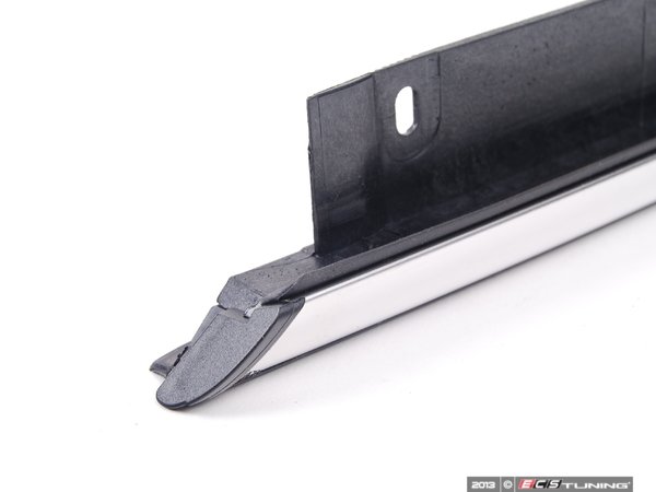

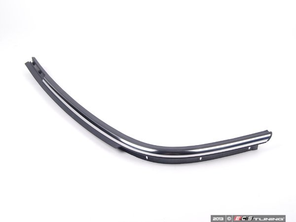

The trim on the sides can be adjusted very slightly. The rear trim that connects to the bottom portion of the top can be moved and aligned also. There is a couple screws and an alignment adjustment right near the gap. See the trim on the rear below for pics.
#2 are those rear sections.
Convertible Top Rear Trunk Molding - Left Side Part #54342758117

Rear side moldings. #10 in the pics. Snap to the sill on the body.

On the rear trim that screws in you can see on the link to the part the fine adjustment slot on the screw holes. Up and down , side to side a little once you loosen up all the screws that go in those holes. Put the top up and lift the convertible in truck expansion position and then you will have access to the screws.
