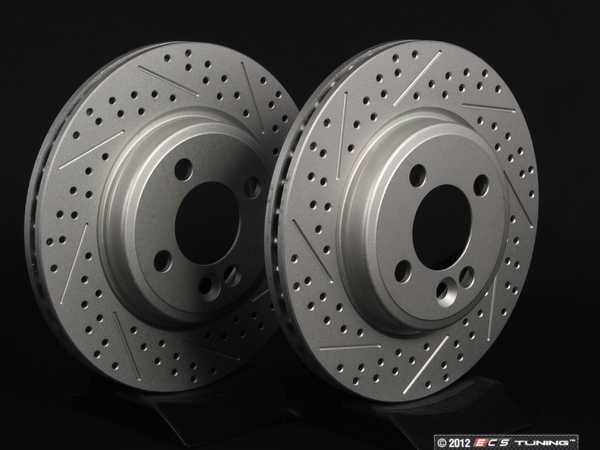

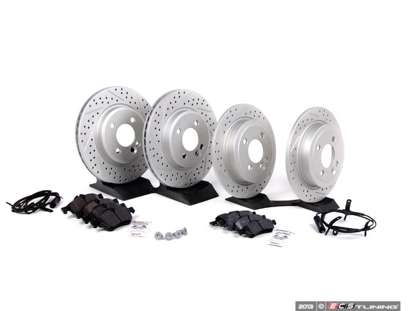

Hello,
You have a later year 2006 R53 MINI Cooper S. You will need the production 7/2006+ rotors. Which is size 276x22mm or 10.86" for the Non JCW Rotors on the fronts. Follow MINI part # 34116774984 .
On the rear you will need the 7/2006+ rotors 259x10mm or 10.19" ( the JCW and Non JCW share the same rotor on the rear). Follow MINI part # 34216774987
Also kits with our ECS Geomet Rotors in Cross drilled / slotted or slotted ( front and rear for both ).
http://www.ecstuning.com/Mini-2006-Cooper-R53-S-Coupe-L4_1.6L_W11B16A/Braking/Rotors/
We have service kits with pads / rotors / sensors / Rotor screws . Follow the same 7/2006+ Non JCW setup for those also..
http://www.ecstuning.com/Mini-2006-Cooper-R53-S-Coupe-L4_1.6L_W11B16A/Braking/Service_Kit/
