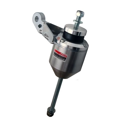

Don't go with stock, go with vibratronics if you can afford it. Stock ones leak and are sloppy.

I'd love a VT one, but 300 smackers is just so much for an engine mount of all things :-P
I have a damper on the engine already, was considering adding an additional tsw to my setup... Dual dampers with a powerflex bushing on th gear box side, then maybe the superpro inserts for the lower mount.
