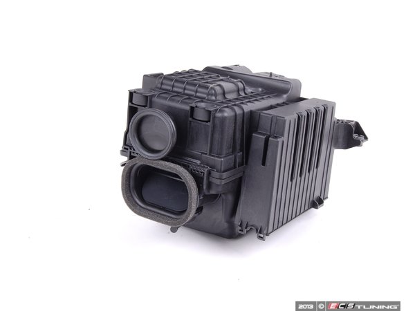

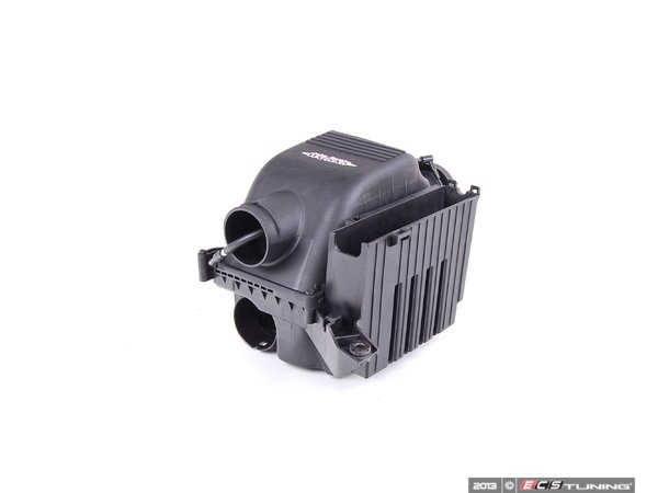

Here is a picture of the JCW intake kit if that helps. Has the different partition then the stock one.
