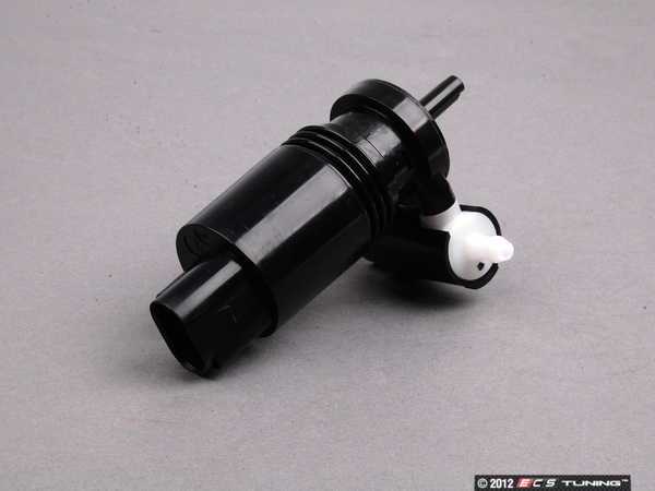

Headlight washer pump. (Left container) Part number 67128377428
http://www.ecstuning.com/Search/SiteSearch/67128377428/

Pump -1/2005 #3 in diagram
http://www.ecstuning.com/Search/SiteSearch/67128377429/

Pump 1/2005+ #3 in diagram
http://www.ecstuning.com/Search/SiteSearch/67126963854/
