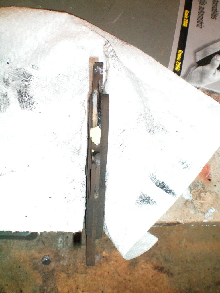

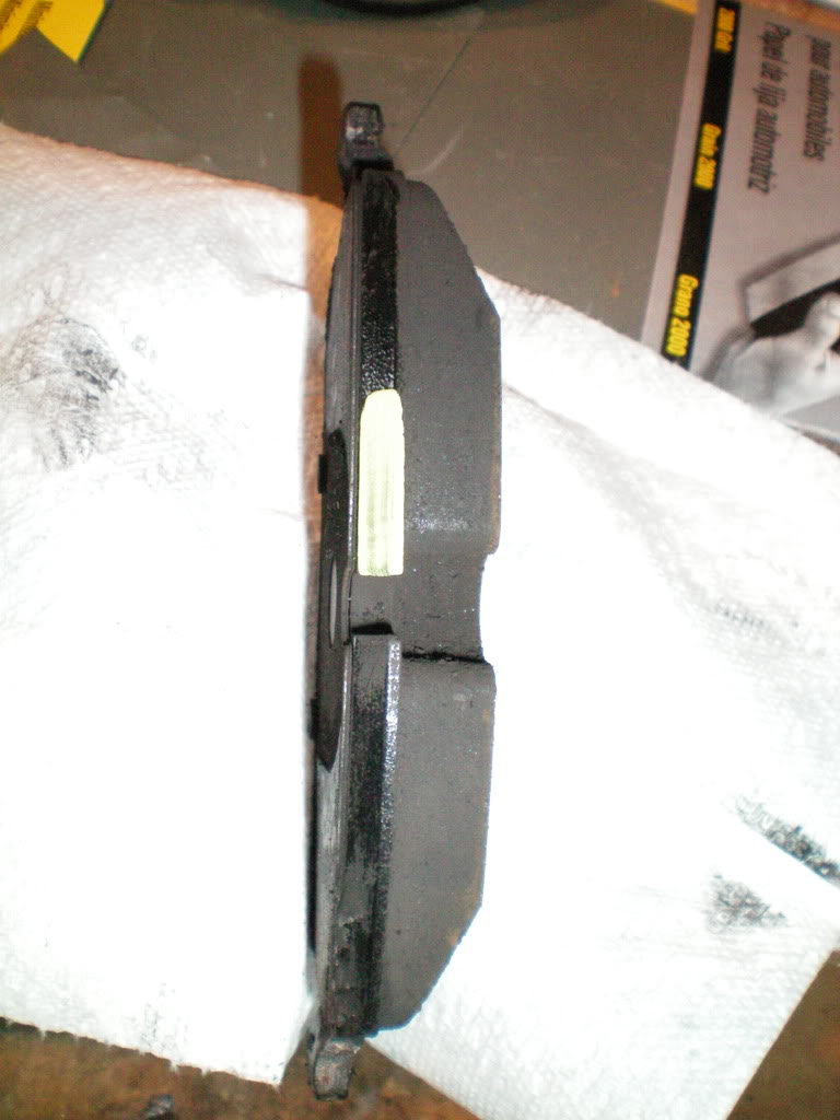

here's a new pad with some white paint on the backing plate
and here's a pad at the end of its life - when the pad material is thinner then the backing plate
bring your car and parts over and I'll hang 'em for free and we'll replace the sliders and see if the problem goes away .... or if you even ever had A problem beyond excessive wear ....
the bottom line - you have yet to find a decent brake guy .... I'd not return to either of these places ....
finding a good mechanic is as important as finding a good dentist .... you would like them to do a good job but not feel like they ripped your big toe off thru your mouth.
