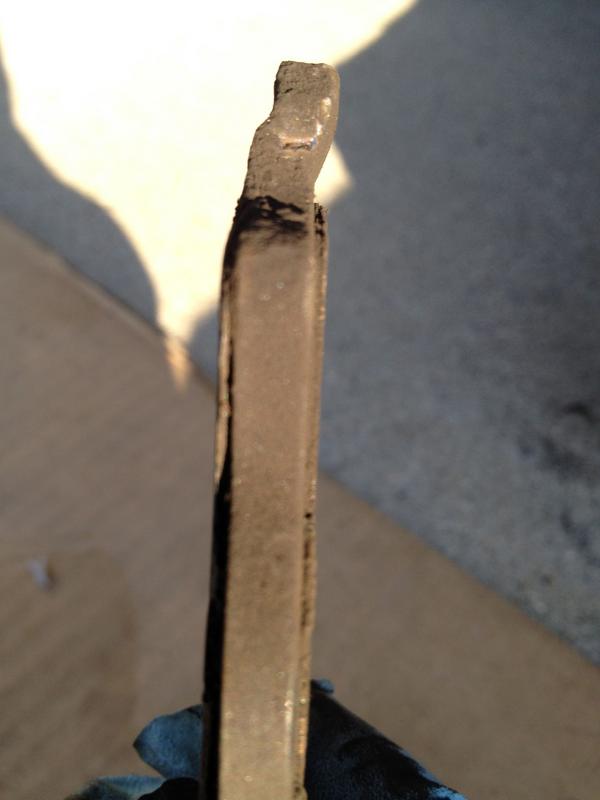

Hello, everyone. I came back from the almost 3 week trip and I did my first DIY project last weekend. All went well, even though of multiple hardware store visits... As I suspected, the right (passenger) rear inner pad was completely worn out (where the noise came from) while the outer pad has a good amount left. One thing I noticed and got me worried was that the left (driver side) rear inner pad was also completely worn out as well... are both calipers gone bad? Attaching the left rear pads pictures...
But with +100 miles driving, no squeals or any signs of issues. fingers crossed.
Thanks everyone for help.
Attached Thumbnails Brake pad wears-img_1383.jpg   Brake pad wears-img_1384.jpg

Did you do anything to your callipers to fix the uneven wear? Or did you just replace pads and plan to see how it goes??
Old Jul 17, 2013 | 02:18 PM
  #36
jamadeus's Avatar
jamadeus
Joined: Mar 2012
Posts: 43
Not really. I wasn't sure if the calipers were the cause, so only thing I did was to clean the calipers and the boots as much as I could and applied silicone lubes underneath the boots. I am planning to check the pads in few weeks to see how the pads are worn.

Cleaning the inside of each caliper with some compressed air and isopropyl alcohol typically does the trick. Brake Pad Change On Your MINI
