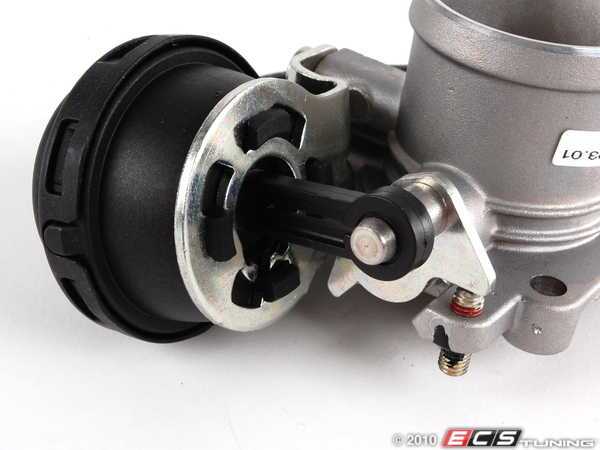

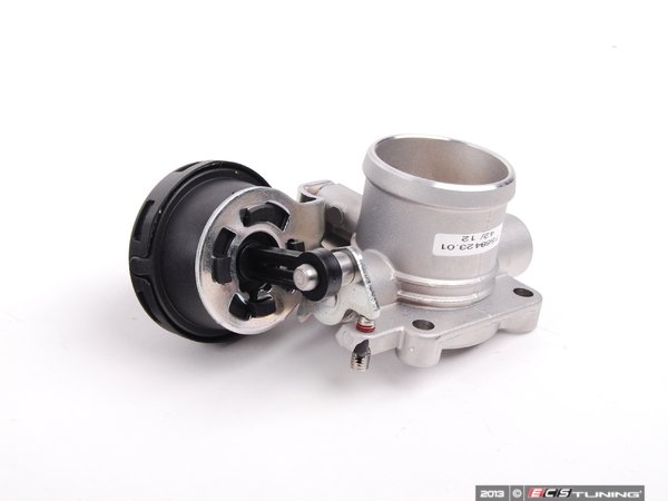

Here is the Bypass valve.
http://www.ecstuning.com/Search/SiteSearch/11617568423/ES25835/
You could loop it around adjustment stop and the metal arm, i don't know if it would be enough to hold it with a zip tie.
I would also check the hose line for leaks and the bottom seal.
That gives you a good picture of it.
