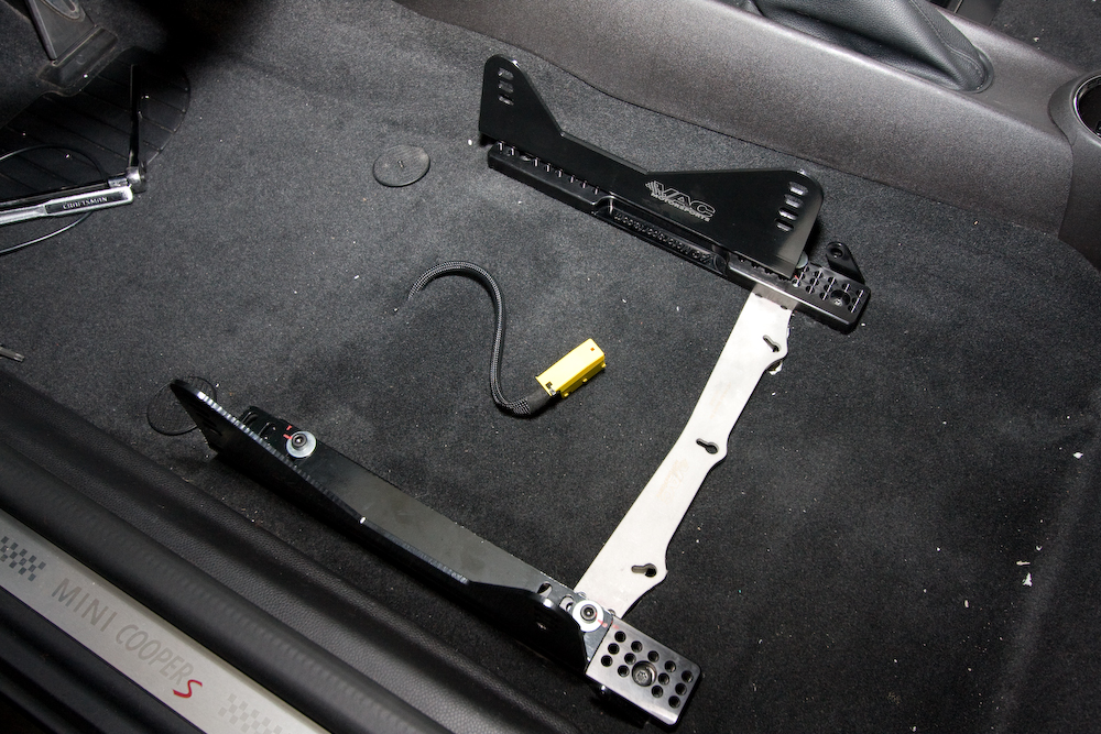

VAC Motorsports floor adapters, seat brackets, anti-sub belt bracket, and lap belt brackets.
