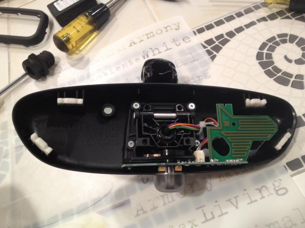

Now that I had the Coupe's mirror in my hands I separated the front trim of the mirror (it holds the actual mirror to the base/housing) by inserting a couple of screwdrivers between these parts. Remember, the front trim has to be "pushed-in" to allow the tabs to be released from the housing. Don't apply too much force as you will break the tabs (I did break one) so take your time and you should be able to achieve this task with little force and a lot of patience.
At this point, this is what you will see:

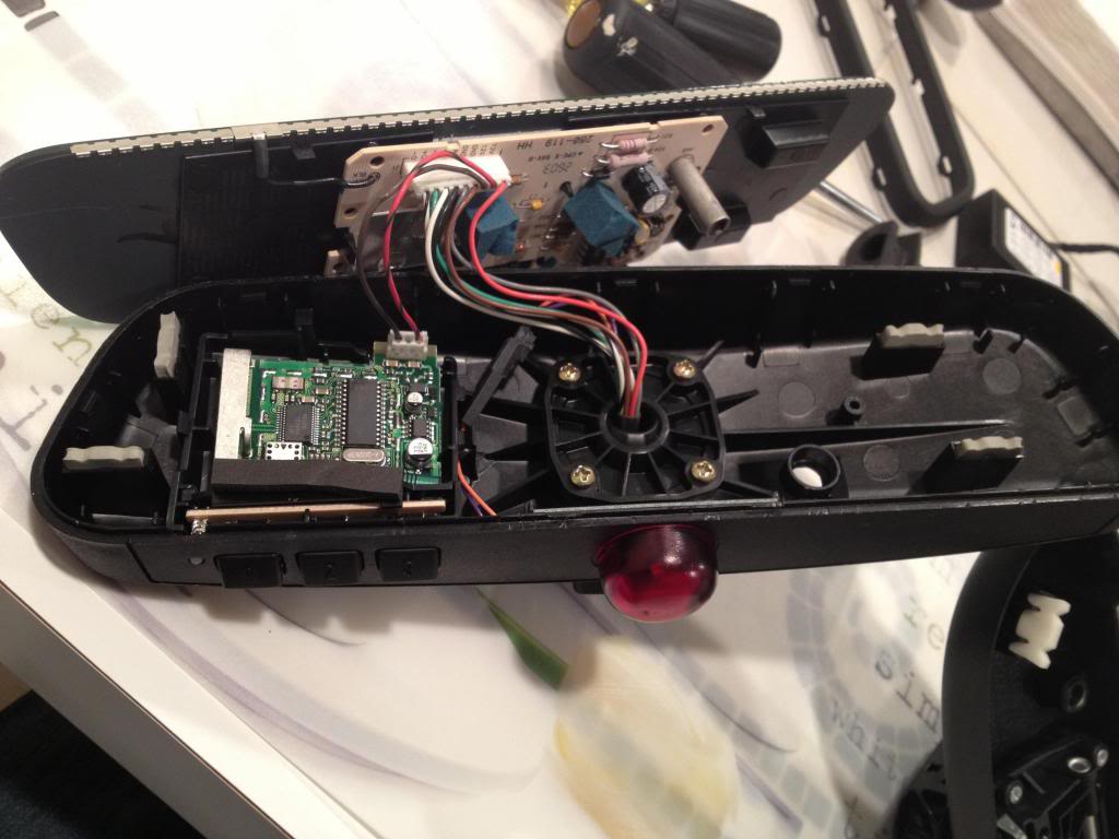

At this point I took the BMW mirror and did the same thing. It was harder to open the trim and I did break a couple of tabs but the mirror is 10 years old and I believe the plastic was dry so... here is the picture of the BMW homelink-equipped mirror:
As you can see, the BMW had many more wires - I don't have a clue how to connect them so I can enjoy the auto dimming function so I have decided to forget the auto dimming and concentrate on getting my homelink function to work. The original mirror has the circuitry for the doors remote open/close function so I had to remove the circuit from the original Coupe's mirror. I had to unplug the connector and "squeeze it" so it will be able to be removed from this mirror and get reinstalled in the new/old BMW mirror. Be careful not to break any wires from the plug:
I did the same thing on the BMW mirror.
Now that the wires were out, I had to use "mini torx" drivers to remove the circuitry from the Coupe's mirror. The biggest problem was removing the normal/night clear button but I managed to remove it too. The truth is that you can break it as it will never be used again but I didn't think about this option and spent a good 30 minutes removing this button from the mirror housing.
Next, I inserted the wiring harness from the Coupe's mirror to the BMW mirror and have installed the circuitry (fits right-in, like a glove and you can add a screw from the Coupe's mirror to hold the circuit board in its place.
